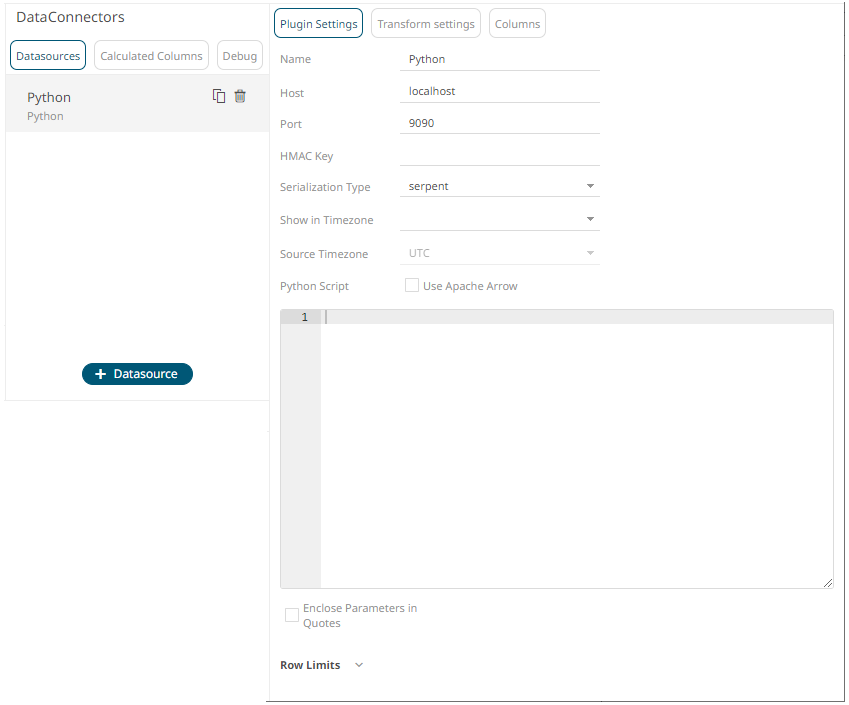

1.     Select Python from the Connectors panel. The Python Settings panel displays.
2.     Enter the Name of the Python data source, then click .
3.     Enter the following properties:

4.     Select the Serialization Type: Serpent or Pickle.

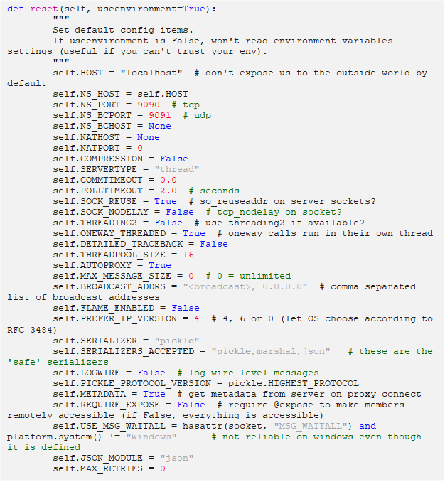

Modify the configuration.py  file located in ..\Anaconda3\Lib\site-packages\Pyro4 to specify the serialization to be used.
For example, if Pickle is selected, self.SERIALIZER value should be changed to pickle and self.SERIALIZERS_ACCEPTED  value should be changed to include pickle:

5.     Date/Time values of output data and Date/Time inputs, where supported, is by default unchanged.
6.     Enter the required Python script to execute on the active Pyro instance.
7.     Check the Use Apache Arrow box to enable fast serialization of data frames.
8.     Select whether the parameters should be automatically enclosed in quotes by checking the Enclose parameters in quotes box.
9.     Set the row limit of the data set.
10.     Tap the Preview Selected Data Source slider to turn it on.
11.   Click  to display the data preview.
