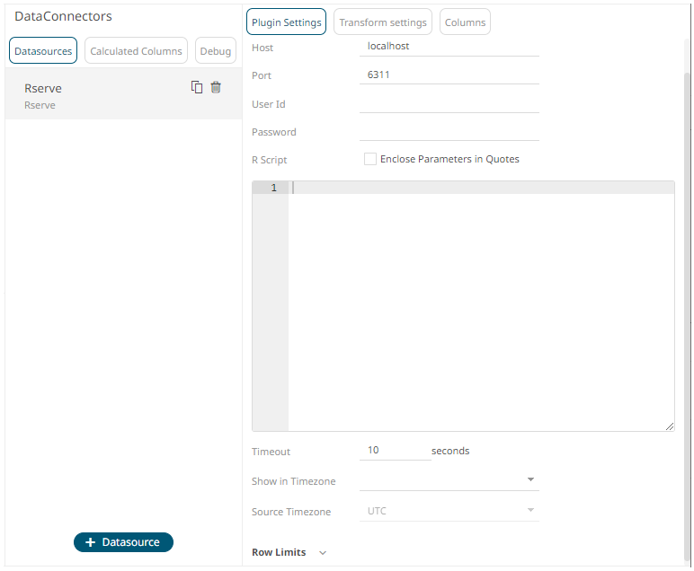

1.     Select Rserve from the Connectors panel. The Rserve Settings panel displays.
2.     Enter the Name of the Rserve data source, then click .
3.     Enter the following properties:
Property
Host
Rserve host address. Default is localhost.
Port
Rserve host port. Default is 6311.
User Id
The user Id that will be used to connect to the Rserve service.
Password
The password that will be used to connect to the Rserve service.
   NOTE
The Host, Port, User Id, and Password fields will be hidden if their corresponding properties are set in the Panopticon.properties file.
Field
Corresponding Property in Panopticon.properies
  Host
connector.rserve.host
  Port
connector.rserve.port
  User Id
connector.rserve.userid
  Password
connector.rserve.password
4.     Enter the required R Script to execute on the active Rserve instance.
5.     Enter the Timeout. Default is 10 (in seconds).
6.     Select whether the parameters should be automatically enclosed in quotes by checking the Enclose parameters in quotes box.
7.     Date/Time values of output data and Date/Time inputs, where supported, is by default unchanged.
8.     Set the row limit of the data set.
9.     Tap the Preview Selected Data Source slider to turn it on.
10.     Click  to display the data preview.
