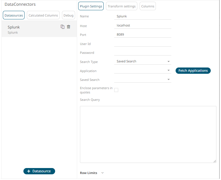

The Splunk connector allows the retrieval of data from a Splunk instance.
1. Select Splunk from the Connectors panel. The Splunk Settings panel displays.
2. Enter the Name of the Splunk
data source, then click
3. Enter the following properties:
Property |
Description |
Host |
Splunk host address. |
Port |
Splunk host port. Default is 8089. |
User Id |
The user Id that will be used to connect to the Splunk service. |
Password |
The password that will be used to connect to the Splunk service. |
4. Select the Search Type:
· Manual
Proceed to step 6 to define a new search query.
· Saved Search
Allows you to select in the Saved Search drop-down list.
5. Click
to populate the Application
drop-down list and select one.
6. Select whether the parameters should be automatically enclosed in quotes by checking the Enclose parameters in quotes box.
7. Enter a Search Query.
8. Set the row limit of the data set.
9. Tap the Preview Selected Data Source slider to turn it on.
10. Click
to display the data preview.
