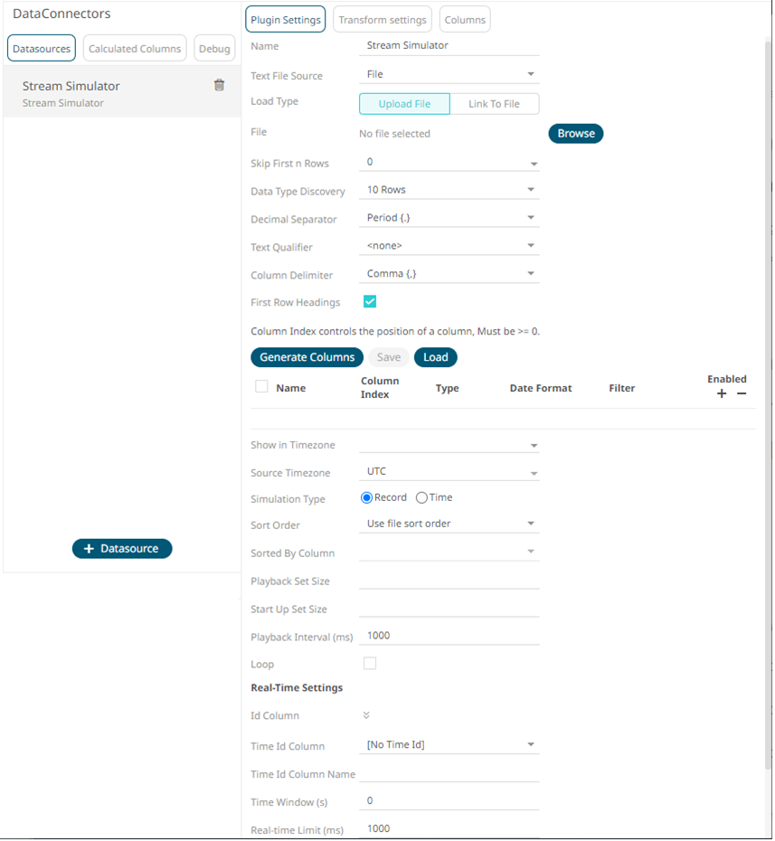

Creating the Stream Simulator input data source includes setting for how fast and how many messages are pushed through in each batch.
1. Select Stream Simulator from the Connectors panel. The Stream Simulator Settings panel displays.
2. Enter the Name of the Stream
Simulator data source, then click
3. Select the Text File Source.
The standard settings controlling how the text file is parsed, is listed.
These include:

4. Click
to the fetch the schema based
on the connection details. Consequently, the list of columns with
the data type found from inspecting the first ‘n’ rows of the input
data source is populated and the Save button is enabled.
This also populates the Id Column with the set of columns, of arbitrary type, that can be concatenated to form a unique row identifier.

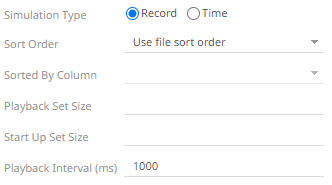

8. Select the Simulation Type:
· Record
Sends the number of records for each interval of time. By default, records are sent in the same order of the source.
This simulation type allows the specification of the following:
¨ Sort Order
When you select the Use file sort order, it will use the default sorting order of the file.
When you either select Ascending or Descending as the Sort Order, this enables the Sorted by Column drop down list.
Select the column that will be used for the sorting.
¨ Playback Set Size
The number of records set to be updated during simulate/playback.
¨ Start Up Set Size
The number of records set to be published initially (on start-up).
¨ Playback Interval (ms)
The update interval period for the record-based playback. Default is 1000 (ms).
· Time
Simulates records as they occur in real-time.
¨ Playback Column
The playback column which is a Date/Time type.
¨ Playback Speed
A multiplier which to either speed up or slow down the playback. Default is 1.
o If 0 < value < 1 slow down
o If value = 1 records will be published as they occur
o if value > 1 speed up

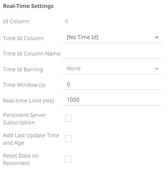

10. For this section:
Refer to Define Real-Time Settings for more information.
