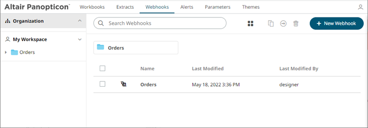

1.      On the Webhooks tab, click on a folder then .

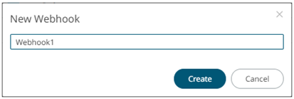

The New Webhook dialog displays.
2.     Enter the name of the webhook then click .

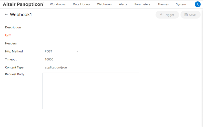

The new webhook is displayed on the Webhook page.

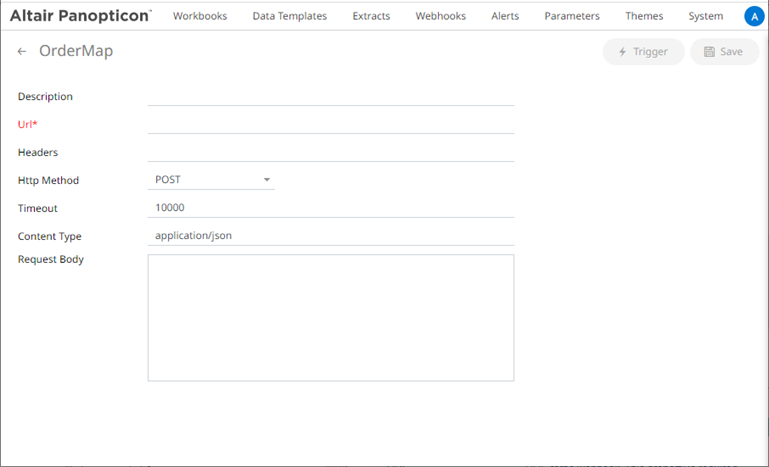

3.     Enter or select the following webhook properties:
Property
Description of the webhook.
URL
URL of the webhook. This property is required.
Headers
A comma separated list of name=value pairs representing HTTP headers.
HTTP Method
Select the appropriate HTTP method for the request from the following options:
·         GET – retrieve data
·         POST – add new data
·         PUT – replace existing data
·         DELETE – remove existing data
Timeout
Timeout (in ms) for reading a response from the URL.
Content Type
The content type of the request body. Default is application/json.
Request Body
The request body to be supplied to the HTTP call.
