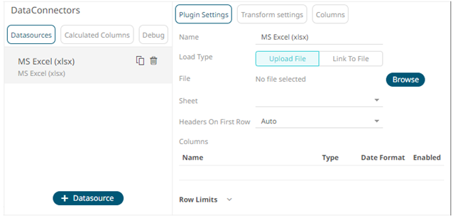

1.     Select MS Excel (xlsx)  from the Connectors panel. The MS Excel (xlsx) Settings panel displays.
2.     Enter the Name of the MS Excel (xlsx) data source, then click .
3.     Select the MS Excel (xlsx) file source. Do one of the following:

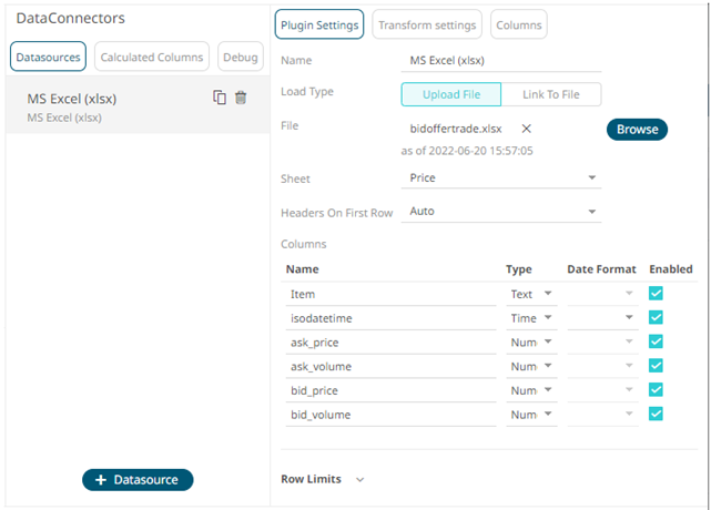

·         Upload a data source snapshot by clicking Upload File  then Browse  to browse to the file source.
After selecting the file, it is displayed with the timestamp of the snapshot.
The data source is placed in the repository and locked, synchronized, and bundled with the workbook version.
To change the data source, click  then Browse  to browse to a new version of the file, which is uploaded into the repository, and also create a new version of the workbook that reads it.

When a file is selected, the MS Excel (xlsx) connector will automatically select the first available sheet, and populate available columns.
4.     Adjust Sheet selection, if required. Selecting a new sheet will re-populate the Columns list.

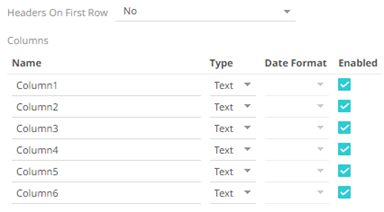

·         Select Yes to force picking first row as headers.
·         Select No to force not picking first row as headers. This will auto generate all column names.
