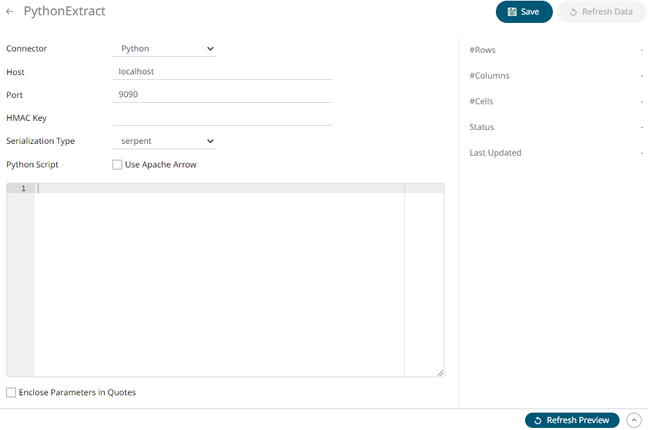

1. On the New Data Extract page, select Python in the Connector drop-down list.
2. Enter the following properties:

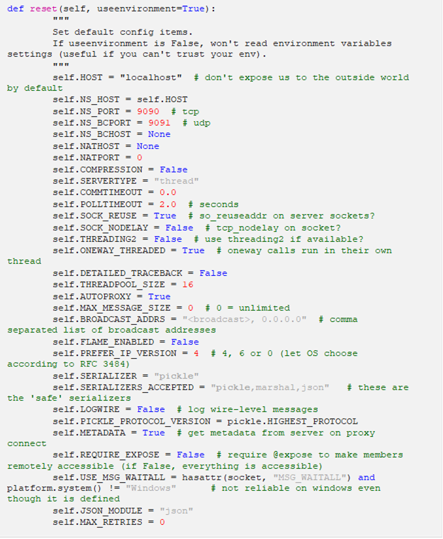

3. Select the Serialization Type: Serpent or Pickle.
· Serpent – simple serialization library based on ast.literal_eval
· Pickle – faster serialization but less secure
Modify the configuration.py file located in ..\Anaconda3\Lib\site-packages\Pyro4 to specify the serialization to be used.
For example, if Pickle is selected, self.SERIALIZER value should be changed to pickle and self.SERIALIZERS_ACCEPTED value should be changed to include pickle:
4. Enter the required Python script to execute on the active Pyro instance.
5. Check the Use Apache Arrow box to enable fast serialization of data frames.
6. Select whether the parameters should be automatically enclosed in quotes by checking the Enclose Parameters in Quotes box.
7. Click
to save and display the details of the data extract.
8. Click
then
to display the data
preview.
