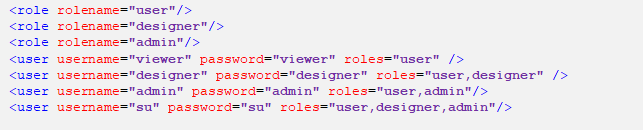

6. For a basic install using the Tomcat inbuilt XML file user directory, copy the provided tomcat-users_example.xml and overwrite the existing tomcat-users.xml file which is available in the Tomcat config folder (\Apache Software Foundation\Tomcat 9.0\conf).
The provided tomcat-users_example.xml contains the following roles and users:
NOTE |
In Panopticon 2020.0 and onwards, the Administrators.txt and AdministratorGroup.txt files are no longer used to authorize administrator users. The function provided by these files has been replaced by a set of properties in Panopticon.properties: access.administrator.groups=admin access.default.roles=VIEWER access.designer.groups=designer access.viewer.groups=user The access.default.roles property defines the default roles assigned to any user accessing the server, defaulting to VIEWER. The administration (access.administrator.groups property) and content creation (access.designer.groups property) on the server are mapped by default to groups named "admin" and "designer". For more complex authentication and user directory options, see section [3] Authentication.

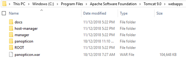

8. Start Tomcat to deploy the .war file.
The panopticon folder is extracted in the Tomcat webapps folder:
The server initializes the AppData directory with an empty content repository and empty subdirectories for other types of data. The Panopticon.properties file is created with the default server properties.

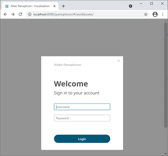

10. You should now be able to log on to Panopticon Real Time using the following:
[Host Name]:[Port]/[Name of your application]
For example:
http://localhost:8080/panopticon

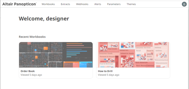

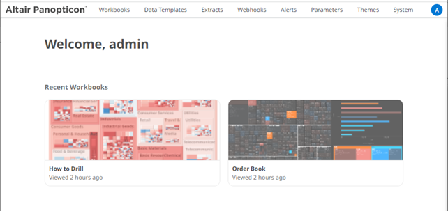

Panopticon Real Time supports different user roles. To have full access to all the services, the user is required to have an ADMINISTRATOR and DESIGNER roles. For example, logging on using the ADMINISTRATOR role added in step 6 (i.e., admin/admin), will display:
All of the available user specific folders in the authentication method used are displayed. However, logging on with a DESIGNER role (i.e., designer/designer) will only display:
The allowed features available for the DESIGNER role is extensively discussed in the Web Authoring Guide. For more information on how to set up the user groups and map them to the user roles, refer to Supported Roles in the Panopticon Real Time.
