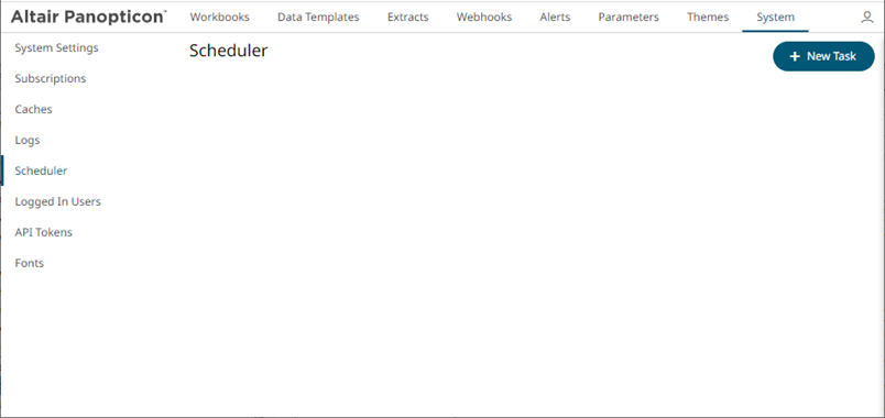

On the Scheduler tab of the System Settings page, Panopticon Real Time allows scheduling of tasks.
A new scheduled task is added in the list with the properties.

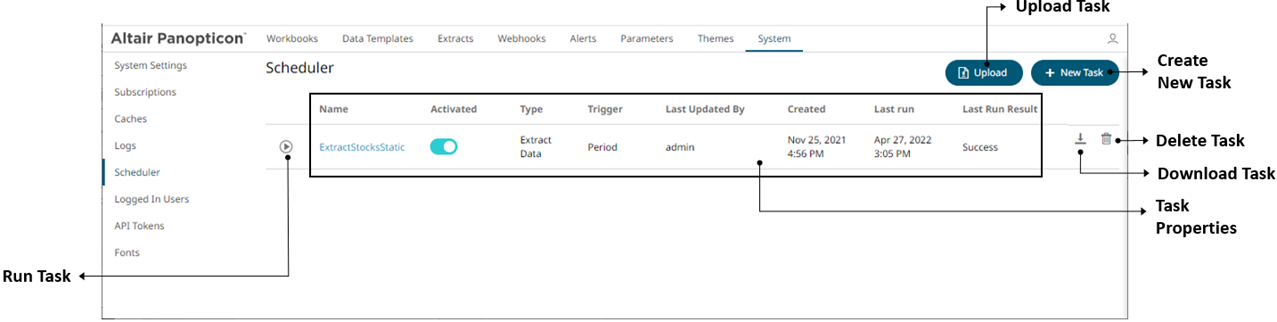

Scheduler Property
Run Task
Manually run scheduler task.
Upload Task
Upload scheduler task.
Create New Task
Create a new scheduler task.
Delete Task
Delete a scheduler task.
Download Task
Download a scheduler task.
Task Properties
The task properties include:
·         Name of the task
·         Activated status
·         Type of the scheduled task
·         Trigger type: Period or CRON
·         Last user who made an update
·         Date/Time when the task was created
·         Date/Time when the task was last ran
·         Last run result: Success or Failed
For failed results, you can hover on the tooltip to view the error.
NOTE: The result is not displayed for Extract Data scheduler type.

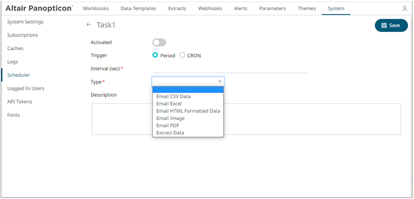

To create a new task, click . The New Task pane displays that allows you to define the following tasks:
q  Sending of a CSV Data via Email
q  Sending of an MS Excel file via Email
q  Sending of an HTML Formatted Data via Email
q  Sending of an Image file via Email
q  Sending of a PDF file via Email
q  Extracting Data
