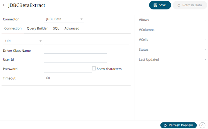

1.     On the New Data Extract page, select JDBC Beta in the Connector drop-down list.

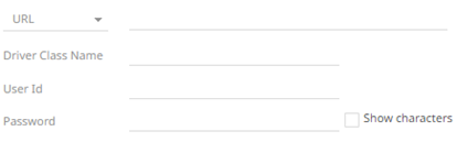

2.     On the Connection tab, set either of the following connection settings:
·         URL
Enter the URL specific to the database’s JDBC driver, the Driver Class Name specific to the driver, and the User Id and Password.
Check the Show Characters box to display the entered characters.
·         JNDI Name
Enter the JNDI resource name to be used.
   NOTE
The JNDI resource name needs to be on the form:
jdbc/[resourcename]
3.     Adjust the Timeout, if needed. Default is 60.

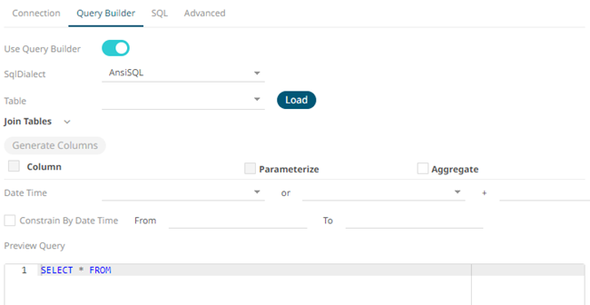

4.     Query definition and execution can be done, using either the query builder or freeform SQL. To use the query builder, select the Query Builder tab. Otherwise, proceed to step 6.
The Use Query Builder option is turned on by default.
4.1.   Select the appropriate SQL Dialect in the drop-down list to be able to generate the correct SQL for the required data repository.

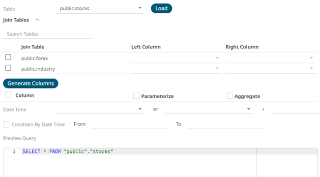

4.2.    In the Table field, click  to populate the drop-down list with tables. Select a table.
The SQL query is generated and displayed in the Preview Query text box.

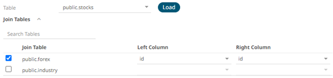

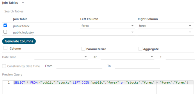

Also, expanding the Join Tables displays the list of tables that you can join.
Use Search Tables to filter the list.
4.3.    Perform a join by checking one or more tables in the list.
You can also opt to select other common fields.

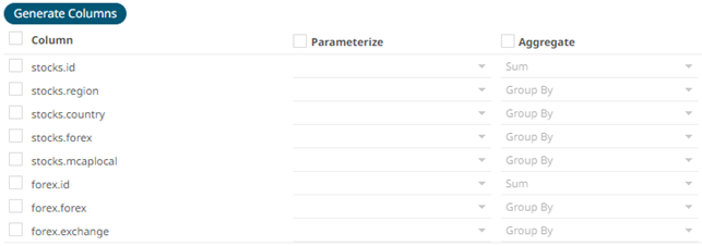

4.4.    Click . The columns populate the Output Column section.
4.5.    Individual columns can be added by checking the corresponding Column box in the Output Column listing. To select all of the columns, check the topmost box.
4.6.    If the data returned is to be aggregated, then the Aggregate box should be checked. For each selected column, the possible aggregation methods are listed including:
¨        Text Columns: Count, Group By
¨        Date Columns: Count, Group By
¨        Numeric Columns: Sum, Count, Min, Max, Group By

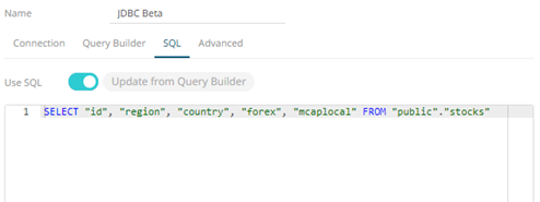

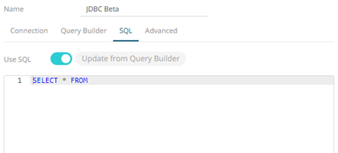

5.     To use freeform SQL, select the SQL tab and turn on Use SQL toggle button.
5.1.    Modify the SQL-like query language in the User Query text box.
   NOTE
·         If you initially used the Query Builder then switched to the freeform SQL option, the content of Preview Query is copied to the User Query text box.
·         Switching back to the Query Builder, the Preview Query is updated, keeping the User Query unmodified.
·          is enabled when User Query is non-empty and different from Preview Query.
Click this button to update the User Query from the query builder.

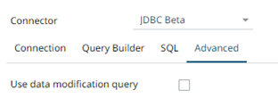

6.     Select the Advanced tab.
Set the following property, if needed:
Property
Use data modification query
Signals that the table is created for writing data. This property is also used for filtering out target data tables for further data update action configuration
