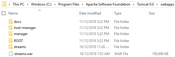

5.     Copy the streams.war file into the Tomcat webapps folder (\Apache Software Foundation\Tomcat 9.0\webapps).

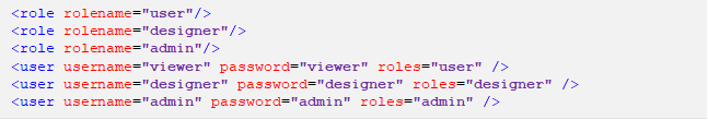

6.     Edit the existing tomcat-users.xml file which is available in the Tomcat config folder (\Apache Software Foundation\Tomcat 9.0\conf) and add the entry:
<role rolename="user"/> <role rolename="designer"/> <role rolename="admin"/> <user username="viewer" password="viewer" roles="user" /> <user username="designer" password="designer" roles="designer" /> <user username="admin" password="admin" roles="admin" />
For more complex authentication and user directory options, see section [3] Authentication.

7.     Start Tomcat to deploy the .war  file.
The streams folder is extracted in the Tomcat webapps folder:

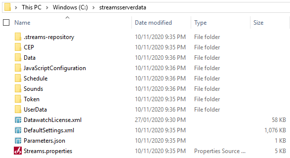

Also, the .streams-repository, CEP, Data, JavaScriptConfiguration, Schedule, Sounds, Token, and UserData folders are generated in the streamsserverdata folder along with the Streams.properties, DefaultSettings.xml, and Parameters.json  files:

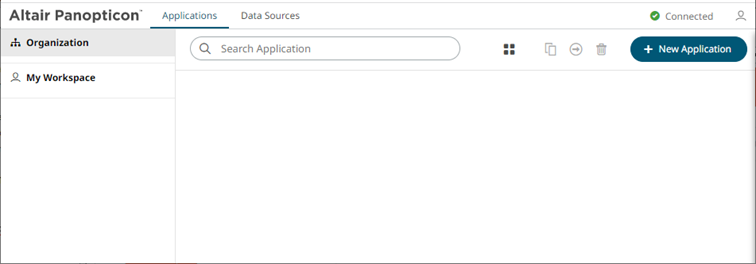

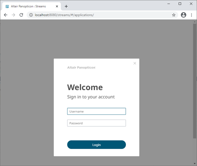

8.     You should now be able to log on to Panopticon Streams using the following URL:
[Host Name]:[Port]/[Name of your application]
For example:
http://localhost:8080/streams
   NOTE

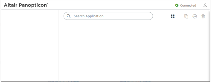

 Panopticon Streams Server supports different user roles. By default, all users are assigned the VIEWER role. For example, logging on using the viewer user added in step 6,  Panopticon Streams Server will only display:
To have full access to all the services, the user is required to have an ADMINISTRATOR role.

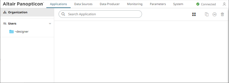

A user with a DESIGNER role can create or upload applications and data sources:
