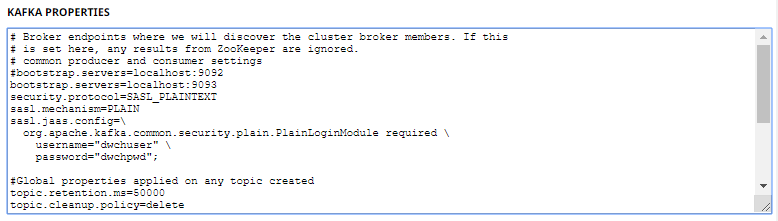

The user-defined Kafka.properties file contains properties for controlling the Kafka configurations in Panopticon Streams.

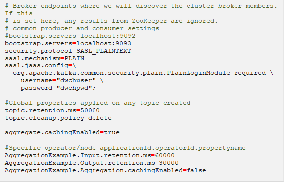

Below is a sample properties file:
When Panopticon Streams server is started, it checks the AppData folder for the kafka.properties file and loads the properties in the Kafka Properties box.

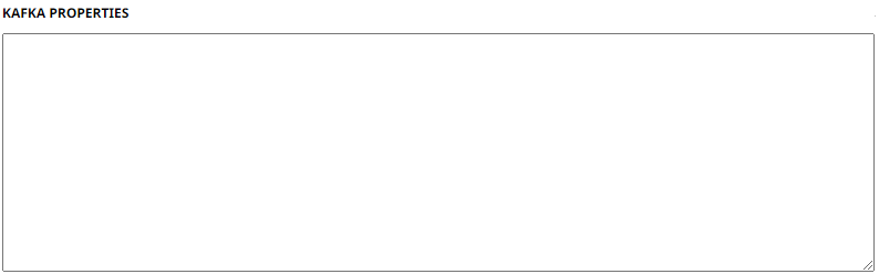

However, if the kafka.properties file is not available, the Kafka Properties box will display a blank Kafka Properties box:
