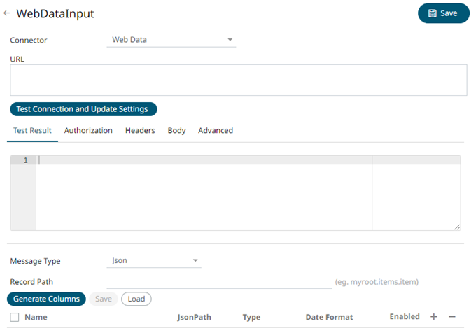

1.    In the New Data Source page, select Input > Web Data in the Connector drop-down list.
2.     Enter the absolute URL of the web data including scheme (HTTP/HTTPS) into the URL field.

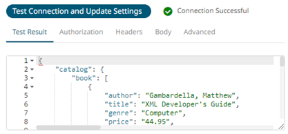

3.     Click . A successful connection will result to the following:
·         The Connection Successful status is displayed along with some raw data returned by the server.

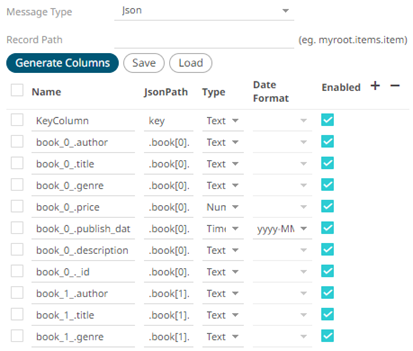

·         Connector tries auto discovery of the Message Type.
You can also opt to load or save a copy of the column definition.

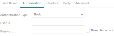

4.     Adjust the Authentication Type, if required.
4.1.   Select the Authorization tab.
4.2.   Set the required settings:
Authentication Type
None
No authentication needed.
Basic
Enter the User ID and Password to connect to the connector’s service.
Select the Show Characters box to display the entered characters.

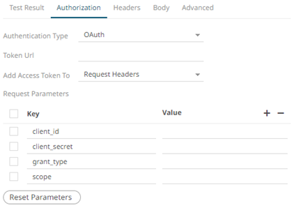

OAuth
Some standard OAuth token request parameters come initialized with empty values. You can set these values and also add/remove any/all of the keys.
Enter or select the following settings:
·         Token URL – The URL to retrieve the access token from.
·         Add Access Token To - The Access token retrieved from the Token URL can be added to headers, URL or request body, depending on how the endpoint needs the token.
o    Request Headers - A header is automatically added to the REST API request.
o    Request URL - The URL needs to be manually parameterised with a {access_token} parameter, before calling the REST API, the parameter is replaced with the actual token.
o    Request Body - The Request Body needs to be manually parameterised with a {access_token} parameter, before calling the REST API, the parameter is replaced with the actual token.
NOTE:
The given request parameters key/value pairs are formatted by the connector as application/xwww-form-urlencoded, and posted to Token URL.

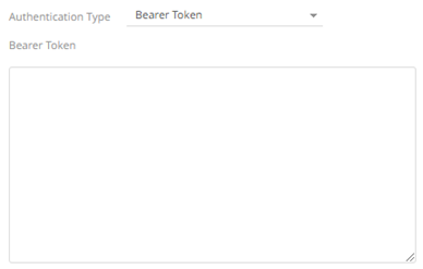

Bearer Token
If you already have a authentication token, enter the token string into Bearer Token input box. This can be parameterized also.

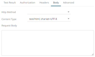

6.     Set the Body, if a POST/PUT request is required.
6.1.   Select the Body tab.
6.2.   Set the required settings:
Property
HTTP Method
Select the appropriate HTTP method for the request from the following options:
·         POST – add new data
·         PUT – replace existing data
Content Type
Select or enter content-type based on request body (payload) format.
Request Body
The Request Body for the HTTP POST method.

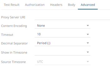

7.     Set the Advanced settings, if needed.
7.1.   Select the Advanced tab.
7.2.   Set the required settings:
Property
Proxy Server URI
The HTTP Proxy setting that will allow the connector to reach the endpoint.
Content Encoding
Select the Content Encoding with the HTTP Header: None, GZip, Deflate, or GZip and Deflate
Timeout
The length of time to wait for the server response (10 to 300). Default is 10.
Decimal Separator
Select either the dot (.) or comma (,) as the decimal separator.
