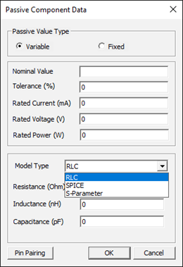

- Passive Component Data: Specify the part values in the form of RLC, SPICE
and S-Parameter.
Figure 2. - Power Rails: Specify the property of power rail for Power Integrity Simulation.
