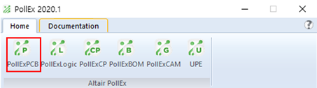

Open and Save PollEx PCB Layout Design File
  1. From the Home ribbon of the PollEx Launcher, click PollExPCB.
  2. From the menu bar, click File > Open and open the PollEx_New_Sample.pdbb file from C:\Temp\Altair-PollEx\PollExPCB.

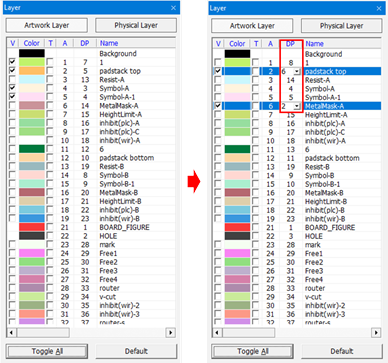

  5. Display the target layer(s).
    1. From the menu bar, select Setting > Layer.
    2. In the Layer dialog, select padstack top and MeatalMask-A.
    3. For MetalMask – A, change the DP value to 2.
      Figure 4.
      MetalMask-A is overlapped on the padstacktop layer.
    4. Close the Layer dialog.

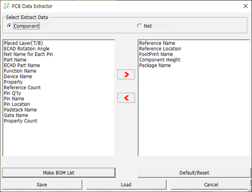

The PCB Data Extractor generates a document of component and net information that can be exported as an Excel file.
  1. Use the PCB Data Extractor to export component and net information.
    1. From the menu bar, click Tools > PCB Data Extractor.
      The PCB Data Extractor dialog opens.
    2. Use the red arrows to move items to be documented from the left column to the right.
      Figure 15.
    3. After the necessary items are selected, click Make BOM List.
      The PCB Data Extractor Result dialog opens.
    4. To export an Excel file, click Export to MS/Excel.
    5. To export Net information (Net length, connected via, total via numbers, and so on), select Net in the PCB Data Extractor dialog and repeat steps 1.b1.d.

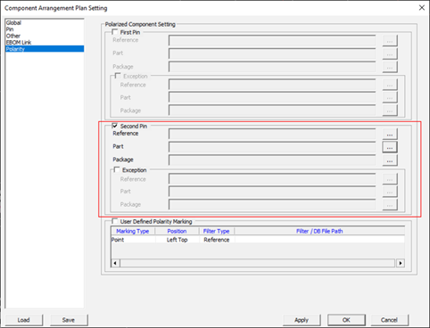

    7. From the Component Arrangement Plan Setting dialog, select COC for Text Area Definition and click OK.
      Figure 28.
      The text for reference name and value is displayed in the COC area.
  2. Display first pin location.
    1. From the Component Arrangement Plan dialog menu bar, click Setting > CAP data setting.
      The Component Arrangement Plan Setting dialog opens.
    2. Select Pin.
    3. At the end of the Reference field, click the ellipses.
      The String Filter Set Up dialog opens.
    4. From the String Filter Set Up dialog, enter U and CN for reference prefix recognition.
      Figure 29.
      References with names starting with U and CN are shown with their 1st pin location.

  3. Display component polarity.
    For components with polarity like a capacitor, you can display their polarity.
    1. From the Component Arrangement Plan dialog menu bar, click Setting > CAP Data Setting.
    2. In the Component Arrangement Plan Setting dialog, select Polarity.
    3. Enable the Second Pin checkbox.
      Figure 32.
    4. Click the ellipses at the end of the Part field.
    5. In the String Filter Set Up dialog, enter CL10, press Enter, and click OK.
      Figure 33.
      This displays the polarity on the second pin of the part whose part name starts with CL10.
    6. Select Global, enable the Polarity checkbox from the Pin Display section, and click OK.
      Figure 34.
