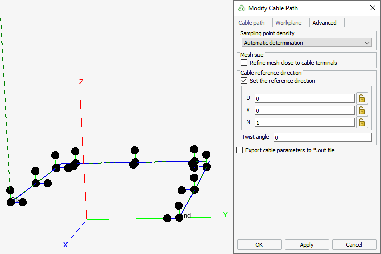

Consider an example where a cable path is created, but with no geometry present in the model.
The Cable reference direction is defined normal to a fictitious ground (in the “up” direction). No twist angle is defined along the cable path.
Figure 1. Specify Cable reference direction with no geometry in the model.
The cable cross section orientation is indicated by:
- dotted green line: vector
- dotted blue line: vector
- solid dark blue line: cable reference direction
Note: CADFEKO tries to orientate the
vector at the start of the cable path to align
with the cable reference direction automatically using the constraint that the
and
vector must be perpendicular to the cable path.

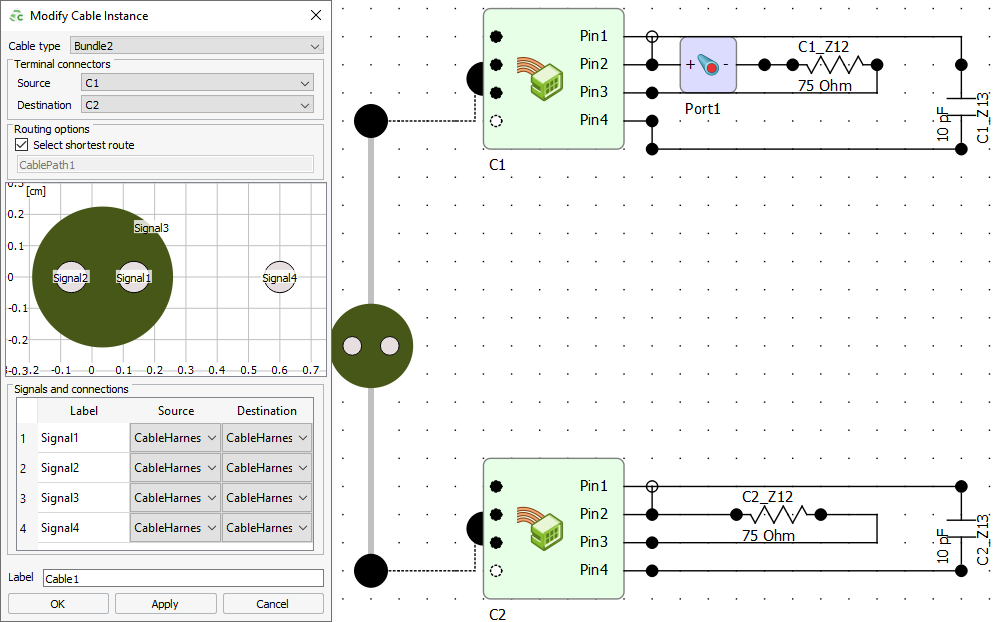

When using the cable reference direction with no installation present, the following
is required in the cable harness and schematic view:
- No bonding impedances are allowed in the harness, for example, no
termination / interconnect
circuit connections to the
installation. - All paths should at least have two signals in the outermost problem to create a return path.
- All paths in the harness should have an orientation vector defined (if that path does not have any nearby geometry / installation).
