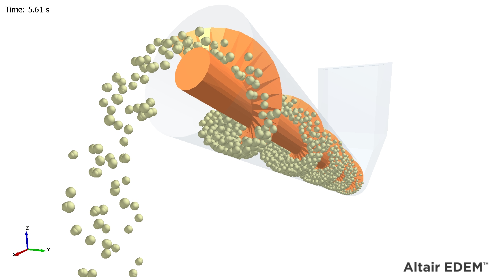

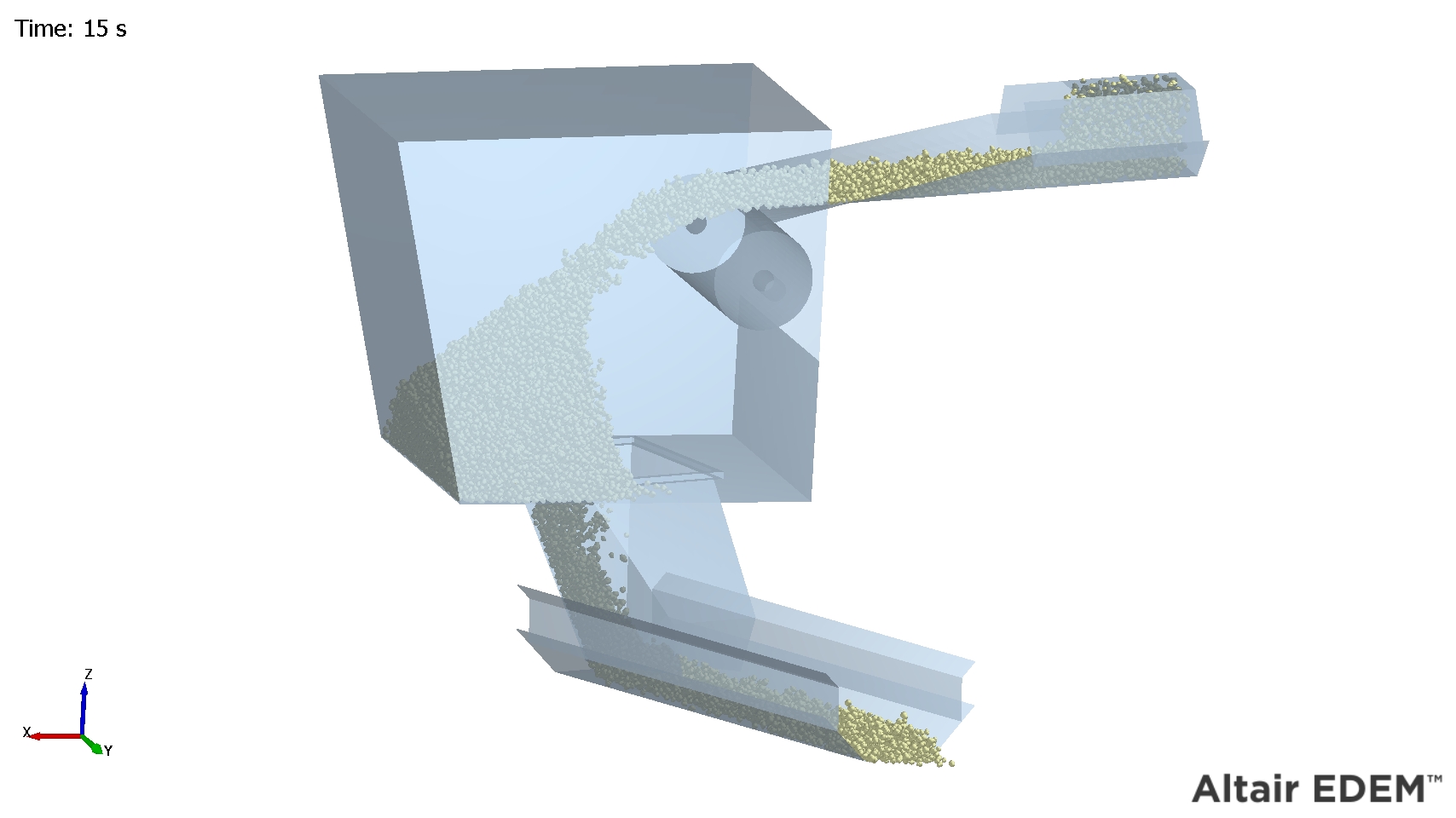

The Geometries subsection allows you to modify and configure the display settings for all the Geometries in the simulation alternatively. If expanded, You can configure the details for each of the geometries in the simulation.
The options include the following:
- The Display checkbox allows you to enable or disable the display of the selected section or selection.

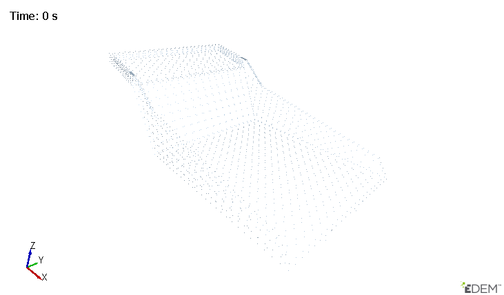

- Display Mode allows you to select between filled, mesh, or point style display. The mesh option can be used to display the triangular elements the section is made up of. The points option shows the vertex of each element.
Filled Geometry
Points Geometry

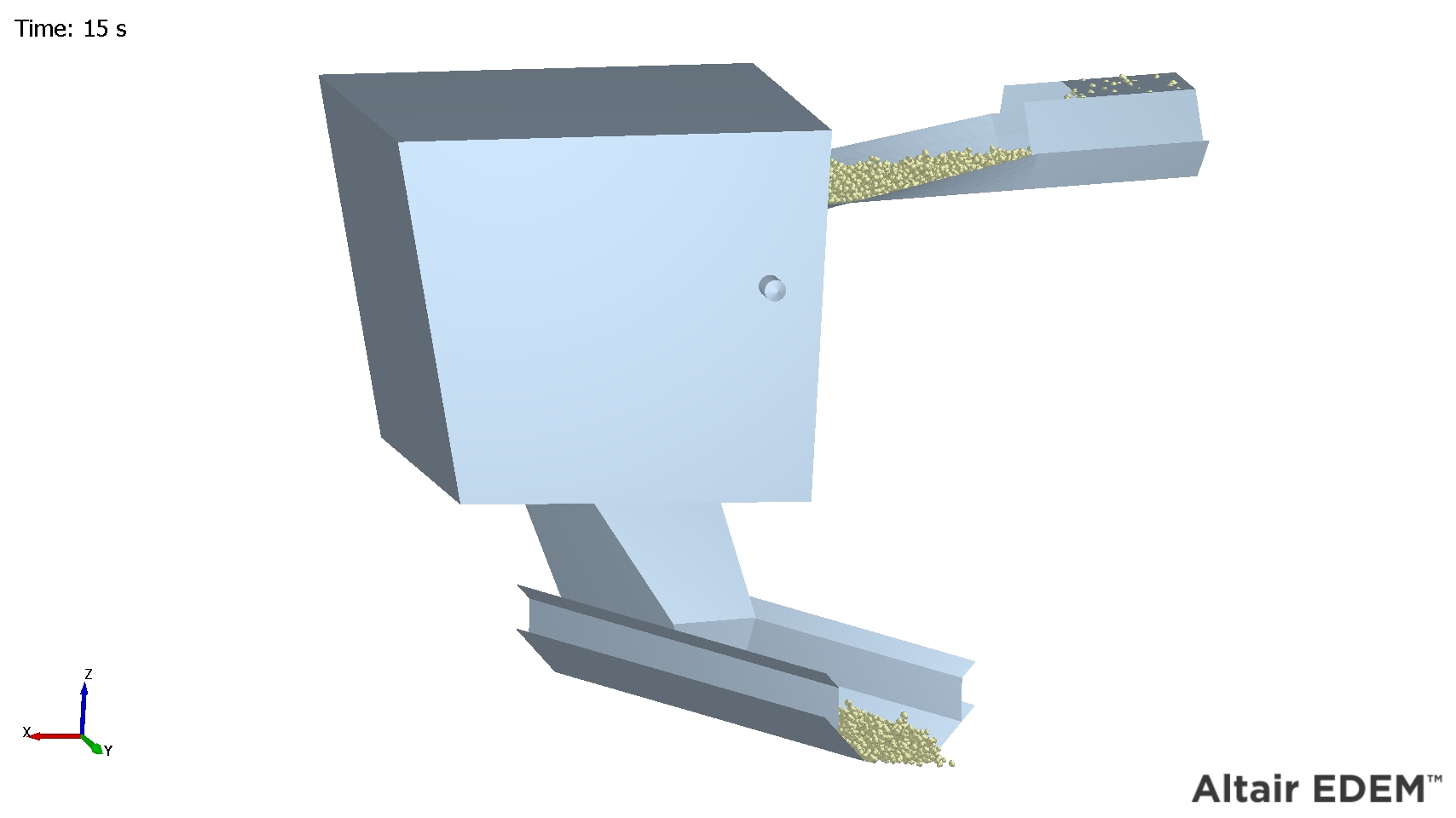

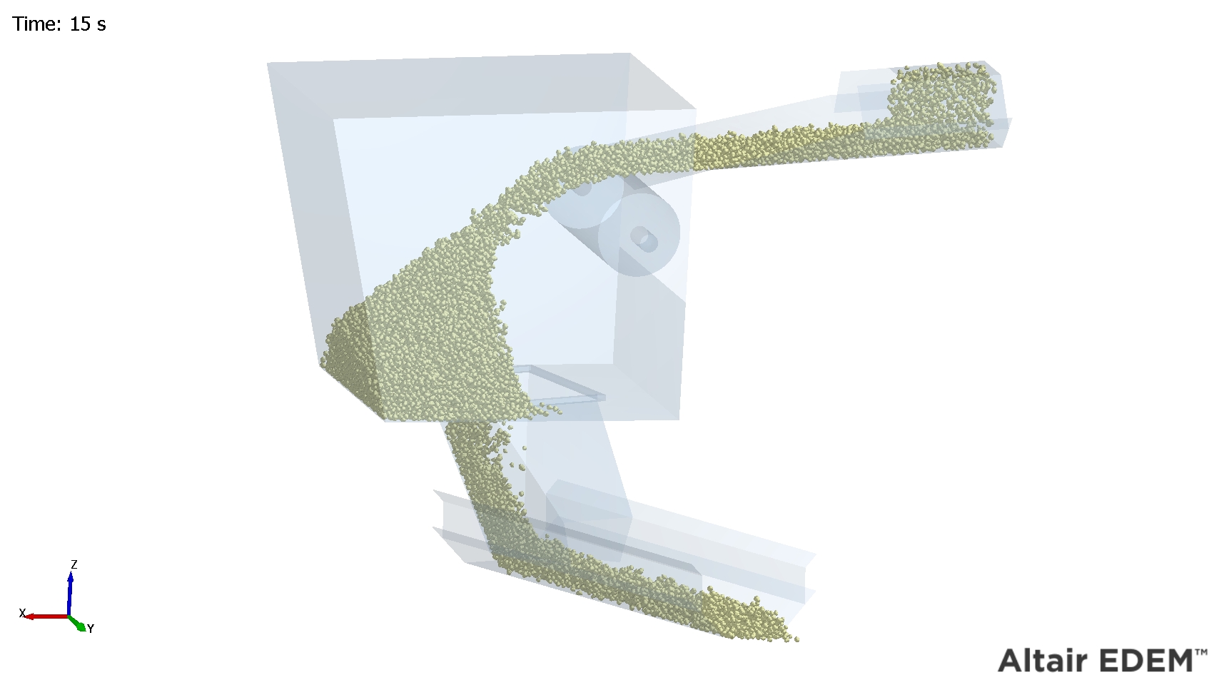

- Opacity allows you to set the opacity level from 0 (fully transparent) to 1 (opaque).
Opacity of 1
Opacity of 0.75
Opacity of 0.25

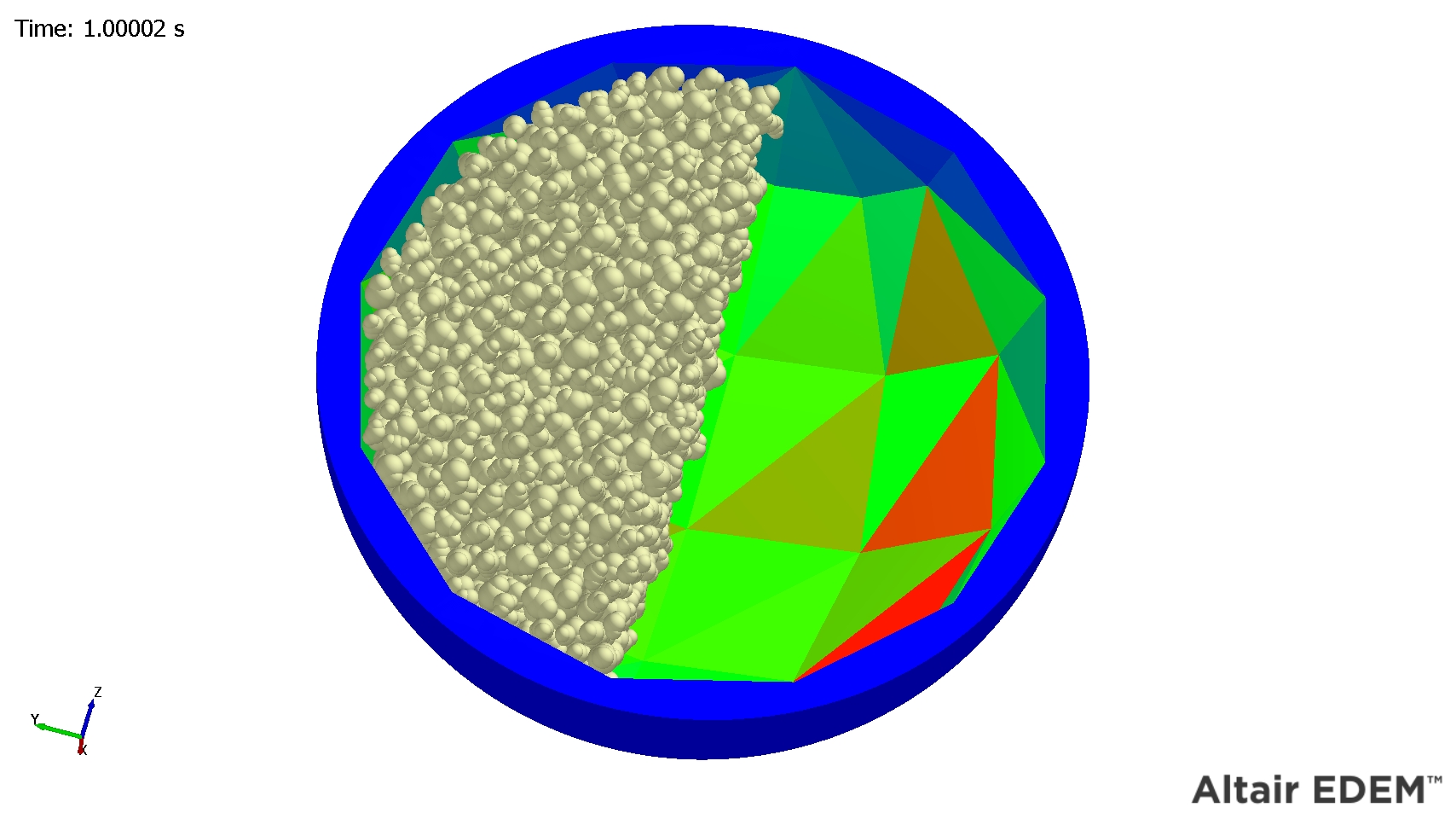

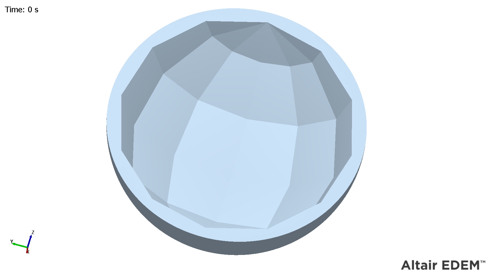

The attributes are Compressive Force, ID, Pressure, Torque, Total Force, or Velocity. The torque selection is the Torque on the individual triangular geometry element based around the position of the contact point relative to the element center point. Selected geometry or geometries will all be colored based on their element attributes. The resolution of the coloring depends on the geometry Mesh resolution.
Geometry shown as few mesh triangles, the coloring is split over the the small number of triangles

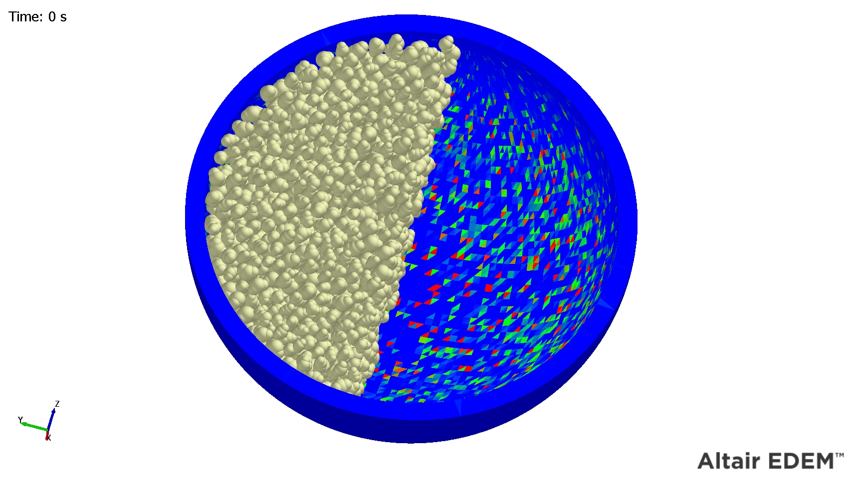

Geometry shown as a large number of mesh triangles can be seen, the coloring can be shown per triangle.
- Smooth Colors
Coloring of geometry attributes can be smoothed to better visualize the color gradation. With Geometry selected from the Element pulldown, select an attribute to color and then select Smooth Colors. Without color smoothing enabled, each geometry triangle is displayed with one color only. With smoothing enabled, the color across each triangle is interpolated based on the value of the attribute at the nodes. - Selecting Multiple Geometries

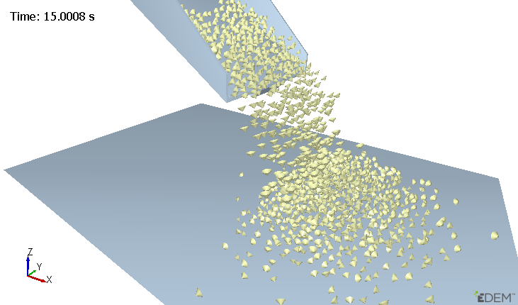

| Cone |
Particles are displayed as cones. The direction, length and base width of the cone can be set to represent a variety of particle attributes..

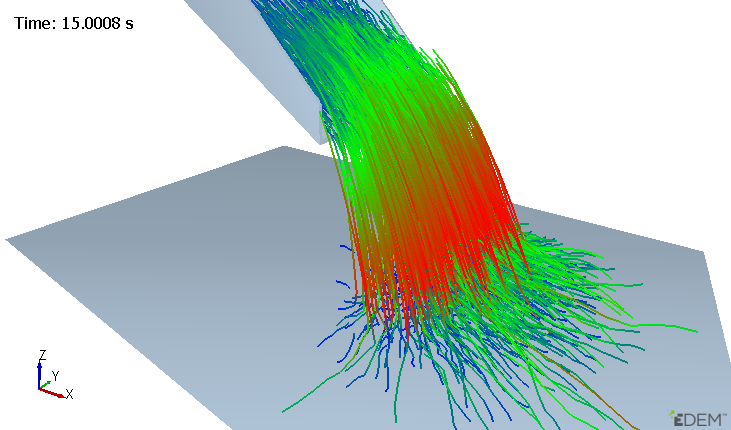

| Steam |
The path of the particle is displayed as a stream with variable coloring.

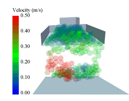

Opacity sets the particle opacity level from 0 (fully transparent) to 1 (opaque). Select the Opacity check box and set the value of opacity to between 0 and 1.
Example of particles colored by Velocity with Opacity set to 0.25:

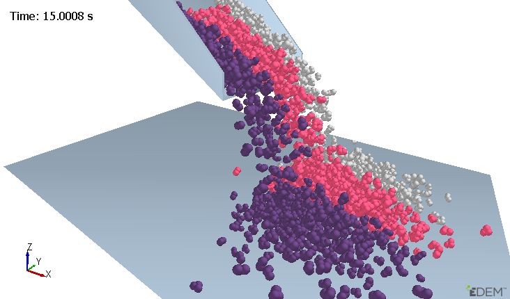

Color By - Uniform allows you to color the selected particle or particles as a whole by one color.
Uniform coloring can be used to set the standard color for any element. The image on the left shows particles in three separate selection groups each colored differently using the Uniform color option.

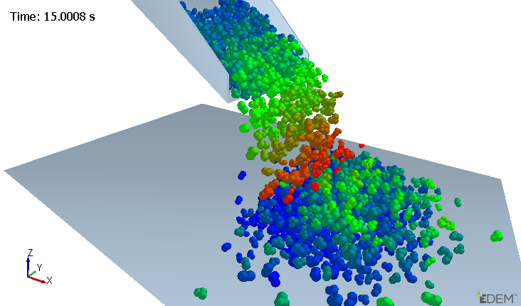

Color By - Attribute allows you to color any particle of the model by a particular attribute: For example, the following figure shows all particles colored by velocity. The particles with the greatest velocity are colored red, and those with the lowest colored blue.
Select the element to color from Color By selection, then select the attribute to color by.
The attributes and their components available for each element are listed in the table below.

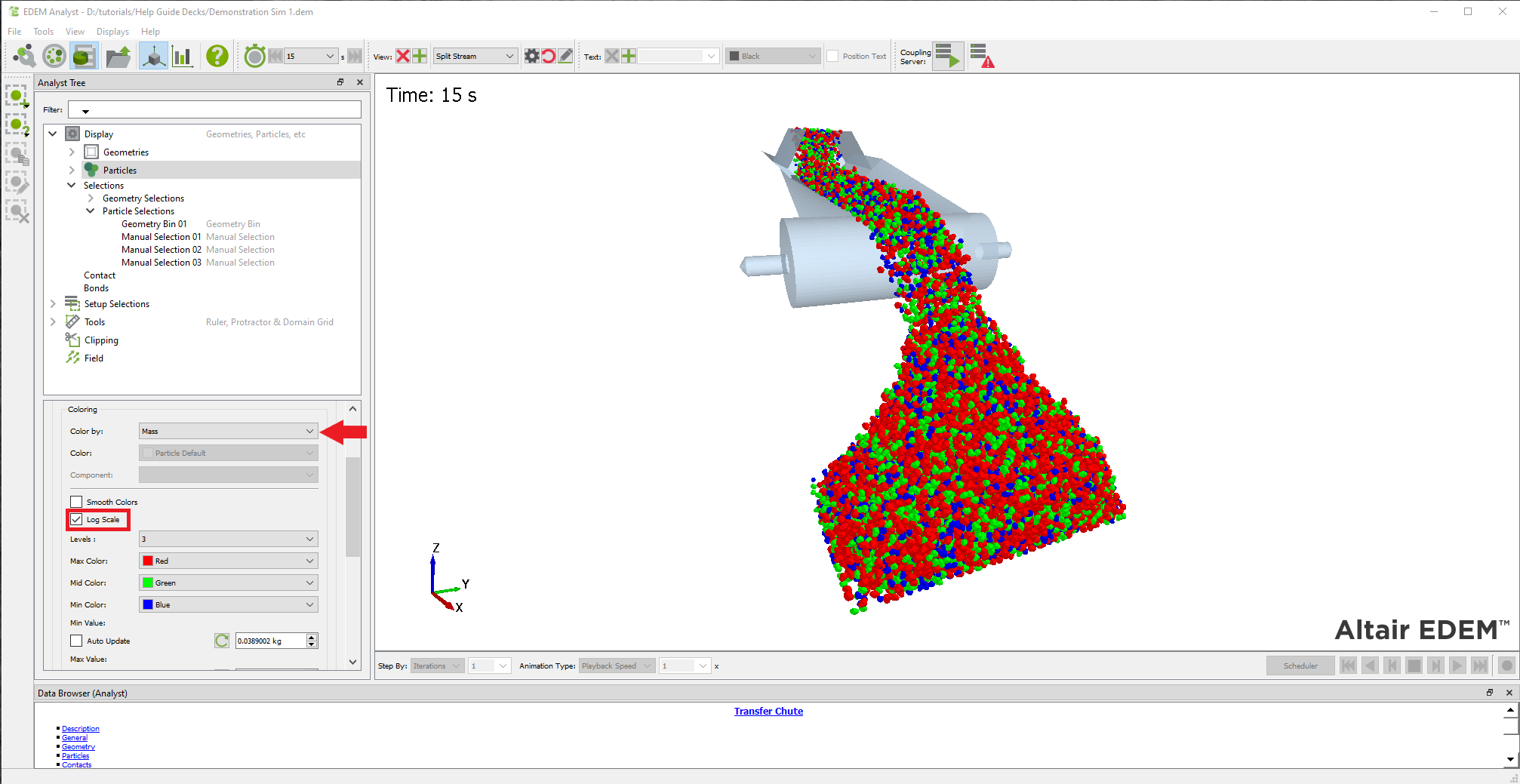

Log Scaling Coloring
Coloring of particle attributes can be scaled logarithmically for better color distribution. This feature allows you to change the coloring from linear to logarithmic and is active for particle Mass and Volume only.
With Particles selected from the Element pulldown, select an attribute to color by Mass or Volume then select the Log Scale checkbox.

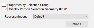

Properties by Selection Group checkbox
For selections, enable or disable if the properties are set for each selection group. This works with the display and color by checkboxes. -

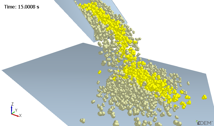

Display checkbox
Enables or disables the display of the selection. For example, if a Manual Selection of particles is highlighted as shown, you can choose to display or hide this selection.
Display box selected
Display box not selected

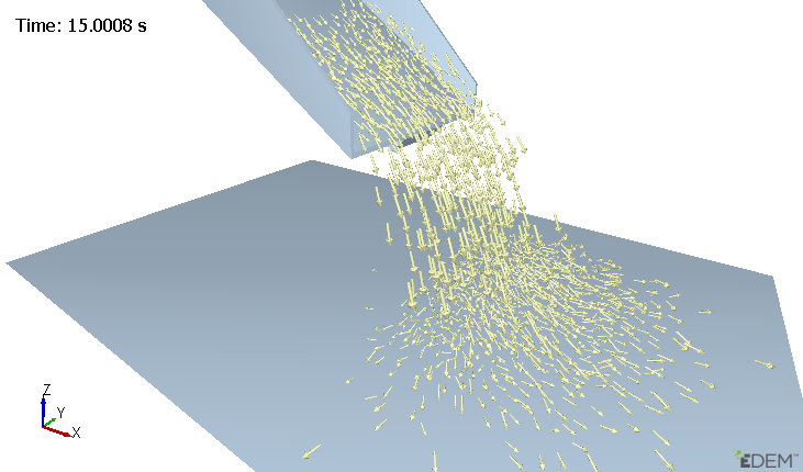

Display Mode
For equipment, select filled, mesh, or point style display. For particles, select default, cone, vector, stream, or template.
Selected group of particles displayed by Vector while remaining particles shown as default:

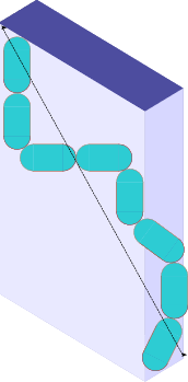

Length Bounding Box
The bounding box method creates a bounding box around the Meta-Particle and then calculates the diagonal for that box.
Length Extent
The extent based method adds the length or diameter of each element in the system. This is good for long continuous meta particles. This method assumes that sphero-cylinders are bonded end to end.

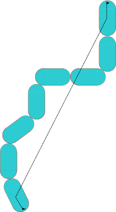

Length Distance-based
The length-based approach takes the two further-apart particles and calculates the distance between those two particles.

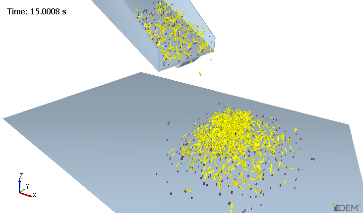

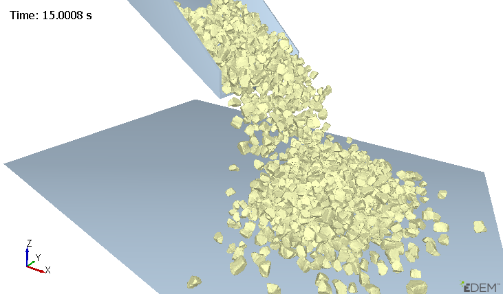

Display Contact Subsection
You can independently examine the contacts between different types of particles and between particles and individual sections of geometry. Use the Particle and Contact with dropdowns to select a pair of elements. Particles can contact with other particle types or equipment types.

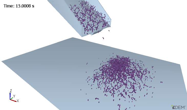

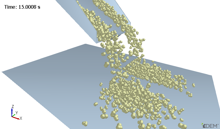

Display Contact checkbox
Displays the contacts in the Viewer. Also, display contacts can result in slow graphics performance.
Standard particle displayed
Particles not displayed and all contacts are displayed

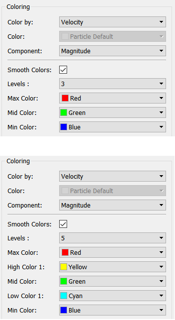

Coloring Levels
Select the desired number of coloring levels from the dropdown list to use in the attribute coloring analysis.
You can customize the colors from all the levels as convenient. 3, 5, 7, and 9 color levels are available.
This enables coloring not to be set outside a min:max range. For example, if using 7 color levels, the minimum two colors can be set to the same value (white or light grey) and the remaining coloring set to bands to just highlight the higher values.
Min Value defines the value of the selected attribute that is going to correspond to the color assigned for the minimum in the legend.
Max Value defines the value of the selected attribute that is going to correspond to the color assigned for the maximum in the legend.
Auto Update enables the checkbox to allow EDEM define the minimum/maximum values depending on the calculated results.
Hide out of bounds hides all the particles when Auto Update is not enabled, and if the value of the attribute colored is outside of the minimum and maximum range.
Coloring Legend
Allows you to display a color legend in the Viewer.
- Select Position Legend and click anywhere in the Viewer to position it.
- Click Legend Options to set the legend’s width, height, number of intervals, alignment, and title.
Select Hide Legends to remove legends for all selected elements.
