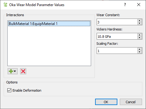

where  captures the normalized erosion due to repeated deformation and captures the cutting behavior of the impact. Using this model in EDEM requires the additional input of the material’s Vickers hardness, Hv (GPa), the material’s Wear Constant, WOka. EDEM also offers the option to deform the geometry according to the quantitative results given by the impact wear model. If you select Enable Deformation, another input parameter called Scaling Factor is presented which allows the deformation results to be scaled as desired.
Interaction Configuration Parameters Position
Particle to Geometry Assign a Wear Constant, Vickers Hardness value for each Equipment Material-Particle interaction and Scaling Factor (if Deformation enabled). Last
To enable geometry deformation, select Enable Deformation in the parameter values GUI.
