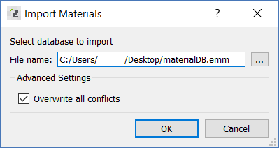

- Click Browse to locate the database required to be imported.
The Overwrite all conflicts checkbox should be checked by default. In most cases, this will be sufficient for importing a database. You can uncheck it if there may be conflicts with material or particle names and they wish to decide what to do for each conflict that occurs during import. - Click OK.
If Overwrite all conflicts is checked, skip to point 6.
If Overwrite all conflicts is unchecked and there are conflicts between the database being imported and the existing database, you will be asked to resolve these conflicts manually. You will be given the choice of overwriting the existing database entry, or renaming the entry being imported.
For example, if you have a Category with the same name, the following options are available:
Use Existing indicates that all imported materials that belong in this category will be imported into this category. Rename means that users will have to choose another name for the category. Imported materials will go in this renamed category.For Material conflicts, the options Overwrite and Rename are displayed.
Overwrite will copy the data from the selected database over the existing database entries. All existing data for that material will be lost. Rename will rename the material being imported into the existing database. The original entry will remain and the imported material will be inserted under the new name. -

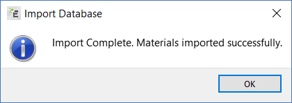

When the import is complete, a dialog box displays that the materials were imported successfully.
