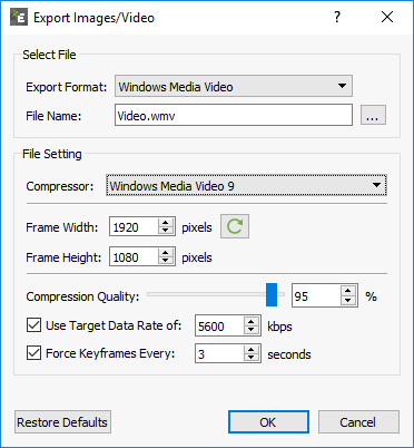

    2. Click the record animationicon in the Viewer.
      The Export Images/Video dialog is displayed.

Video Configurations
  1. Export Format
    Set the export format to either EnSight Video, AVI, WMV, MP4, MKV or WebM.
    1. Select EnSight Video to save the video as a .evo file which can then be viewed using CEI’s EnVideo, or edited using EnVe.
    2. Select AVI Video to save the video as a .avi file. Save your video as an AVI when you want to use a particular codec (compressor) or when you need a high degree of video configuration. You can use any codec installed on your system (Cinepak, DivX, Xvid, or H.264). Videos created in AVI1.0 format have a 2Gb size limit.
    3. Select Windows Media Video (WMV) to use Microsoft’s video codecs. A WMV file is better suited for sharing, since it should play on any Windows PC without the need to install video codecs. You can also set a constant bitrate, useful for streaming the video from a website.
    4. Matroska (MKV) format is an open source format popular for supporting addition of high quality video and audio.
    5. MP4 format with H.264 encoded video is recommended for YouTube uploads. Is supported by most modern phones.
    6. WebM is an open media file format designed for the web.
  2. Select Compressor
    Select the codec to use video compression or uncompressed to not use video compression. The list of codecs available depends on those installed on your system and on which operating system you are running EDEM. Ensure that the system on which you intend to playback the video also has the same codec installed.
    1. For AVI Video, select a codec then (if available).
    2. For EnSight Video, select Motion-RLE for lossless video files or select Motion-JPEG for compressed video.
      NOTE
      The EDEM team does not provide support for external codecs developed by third parties. See the  codec’s documentation or developer’s website for assistance.
  3. Video Options
    Set the frame options and encoding quality as necessary.
    1. Frame Width sets the width of the video. For example, 640 pixels.
    2. Frame Height sets the height of the video. For example, 480 pixels.
    3. Set to Screen Size sets the width and height to match the screen size. Click the icon to set the width and height to match the screen size. The video exported will be the same dimensions as the Viewer.
    4. Compression Quality allows you to use the slider to set the encoding quality (where available). The higher the quality, the larger the size of the video.
    5. Use Target Data Rate allows you to specify a Constant Bitrate (CBR). You would typically use this when you want to stream the video from a website.
    6. Force Keyframes allows you to set how often to write a keyframe to the video. Because video compression only stores incremental changes between frames, forcing keyframes can result in a video that is easier to fast-forward or rewind.
