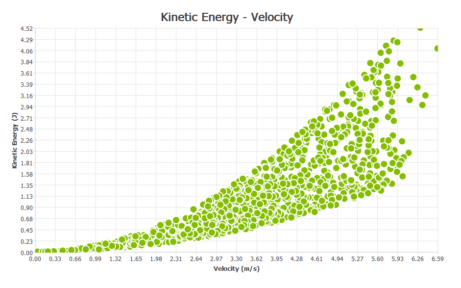

A scatter plot displays the distribution of two variables that are well correlated with each other. The value of one variable is measured on the X-axis and the values of the other on the Y-axis. A wide scatter of the plots denotes poor correlation between the two variables. If the two variables are perfectly correlated, then all the plots will fall on the diagonal (regression line), such as the velocity of a set of particles vs kinetic energy.
As expected, the kinetic energy is higher with greater particle velocity, and the distribution of energy is due to the particle size distribution.
