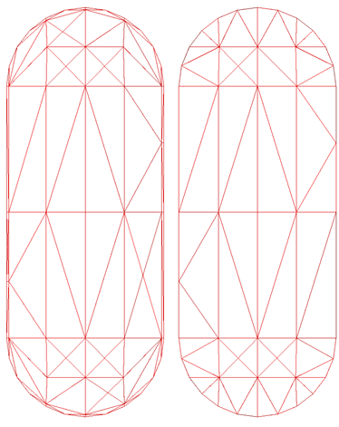

The Delaunay Triangulation algorithm is used when you import a custom particle shape to ensure that the particle is convex. Based on Delaunay meshing, this will produce a shape that is compatible with the EDEM Polyhedral solver. You can use this option only on shapes that are nearly convex but have minor concavity due to the meshing process or CAD generation. Delaunay triangulation is used to maximize each triangle's minimum angle. This produces a mesh with no high aspect ratio or slither triangles and frequently reduces the number of triangle elements.
The following example shows a Standard and Delaunay import:
                                                                                     Standard Import   Delaunay Import
