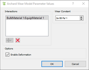

The input to EDEM is the wear constant W with units 1/Pa.
| Interaction | Configurable Parameters | Position |
| Particle to Geometry | Assign a Wear Constant value for each Equipment Material-Particle interaction. Record Relative Wear (On / Off), see Hertz-Mindlin. | Last |
EDEM also allows you to deform geometry according to the quantitative results given by the Archard Wear model. To enable this feature, select Enable Deformation in the parameter values GUI as shown.
