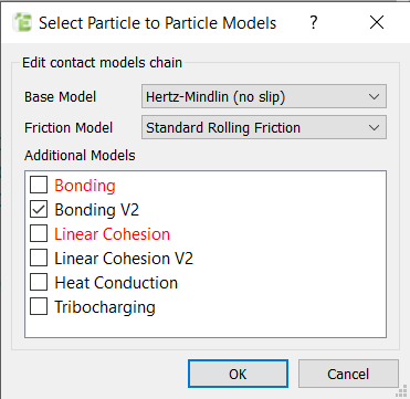

The Bonding V2 model
Creator-Physics allows you to access Bonding V2, which is an updated GPU compatible model based on the original Bonding physics model.

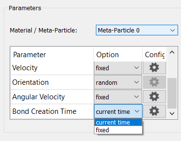

Bonds are created based on two methods -  ‘current time’ or ‘fixed’.  Once the bond model V2 is selected, these options are displayed in the Factory creating the Bulk Material or Meta-Particles. Current time allows the dynamic creation of bonded materials and fixed time allows the creation of bonded material at one user-defined point in time.
If the Bulk Material Active Bonds are defined and the Particles that comprise of the Bulk Material are in contact at the bond creation time, the bonds are formed according the bond parameters. This occurs once per simulation for each particle pair. Once the bond time has passed no new bonds will be formed.
The user also has the option to use a custom API factory to create material and use the Bonding V2 model.  The API factory can be set to assign a Custom Property with name CREATIONTIME = "Bond Creation Time”.  The factory must then assign a value to the custom property equal to the current simulation time. EDEM will then create bonds between particles if the particles are in contact and both particles have a Custom Property CREATIONTIME value equal to the current simulation time.  The custom property must be defined with 1 element and unit of eTime.

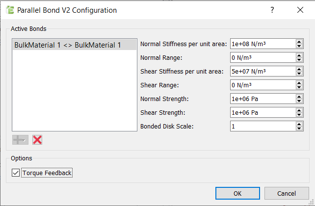

Select an active bond then set the Bond Formation method and the following parameters:
  • Normal Stiffness per unit area: the tensile/compressive stiffness along the bond’s principal axis.
  • Normal Range: The applied Normal Stiffness per unit area value assigned to the bond pair is a value randomly. distributed between the Normal Stiffness value + or – the Normal range value.
  • Shear Stiffness per unit area: Shear stiffness in the orthogonal plane to the bond’s principal axis.
  • Shear Range: The applied Shear Stiffness per unit area value assigned to the bond pair is a value randomly distributed between the Shear Stiffness value + or – the Shear range value.
  • Critical Normal Stress: the maximum normal stress the bond can withstand before it fails.
  • Critical Shear Stress: The maximum tangential stress the bond can withstand before it fails.
  • Bonded Disk Scale: The radius of the cylindrical bond between the particles will be equal to the smallest particle radius in a bond pair multiplied by the bonded disk scale value.
  • Torque Feedback: Enables the Bond Torque to be returned to the Particle.
Set the bond stress and stiffness values to represent the material that is been modeled. A high stiffness value will produce high bond forces and stresses. A lower than normal Time Step may be required to accurately capture these high forces.
