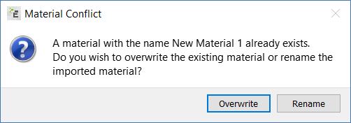

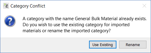

    4. If Overwrite all conflicts is unchecked and there are conflicts between the database being imported and the existing database you will be asked to resolve these conflicts manually. The user will be given the choice of overwriting the existing database entry, or renaming the entry being imported.
      For example, if you have a Category with the same name, you will be given the following options.
      Use Existing will mean that all imported materials that belong in this category will be imported into this category. Rename means that users will have to choose another name for the category. Imported materials will go in this renamed category.
      For Material conflicts you will see a dialog with the options Overwrite and Rename.
      Overwrite will copy the data from the selected database over the existing database entries. All existing data for that material will be lost. Rename will rename the material being imported into the existing database. The original entry will remain and the imported material will be inserted under the new name

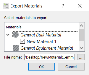

    6. Export. Export all or a subset of materials to be written to a new database file. When selected a dialog will appear where you can select which materials are to be copied to a new database file. The user selects the materials to export, and any associated components of the DEM Material Model (for example, particles and templates) will also be exported.

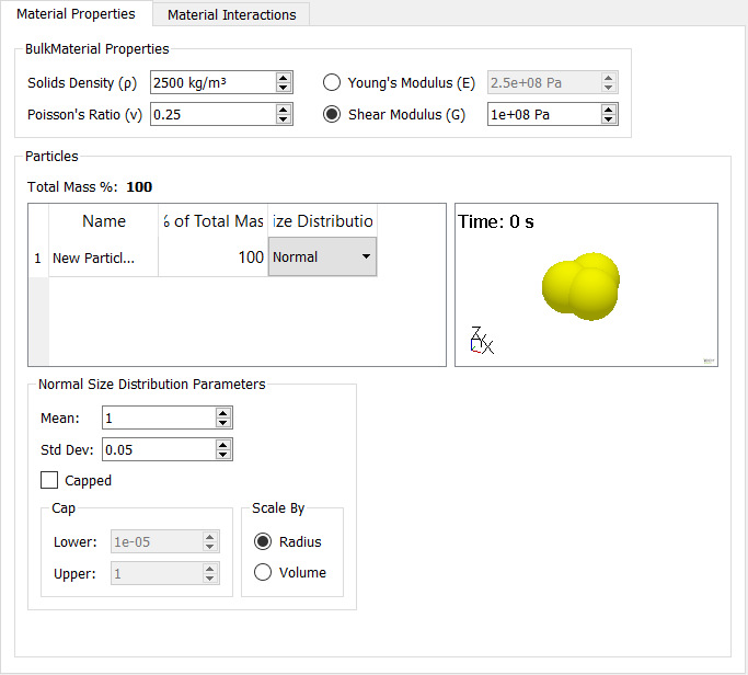

The Material Properties tab is split into two sections, Element Properties and Particle Shapes. The Particles Section will only be shown if a bulk material is selected. Equipment materials do not have particles associated with them. If more than one material is selected, then the Material Properties cannot be edited.
Element Properties
Here you can specify the Specific Density, Poisson's Ratio, and Shear Modulus or Young’s Modulus. The Shear Modulus and Young’s Modulus are dependent on one another so you can enter one and the other will automatically be calculated using Poisson’s Ratio.
Particle Shapes
In this section you can specify the particles that will be used to make up the bulk material. The section contains a table where you can add particles (created in the Particle Shape Editor) to a material. Above the table it shows the Total Mass % for that material. On the right there is a 3D viewer panel that shows the particle that is currently selected in the table. At the bottom the parameters for the size distribution for the currently selected particle are shown.
Please note: this section will not appear if an Equipment category material is selected.
Particle Table

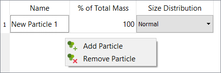

This table contains the particles that will be generated by a bulk material. If you right-click on the table, a menu will pop up that allows particles to be added or removed from a material.
When you select Add Particles, a dialog box is displayed with a list of all the available particles. There is no limit on the number of different particles that can be added to a material, however particles that have already been added cannot be added again.
Once you have added the required particles, the next step is to determine the percentage of the overall bulk mass each particle will account for.
Above the table is shown the Total % Mass for that material. This will be black if the values in the % of Total Mass column all add up to 100%, otherwise it will be shown in red to show that you should amend the values for 1 or more of the particles.
You can also specify a range of size distributions for each particle within the Size Type column. The size distributions available are: Fixed, Normal, Log Normal, Random, and User Defined. The size distributions parameters can be changed below the table. See Size Distribution Parameters section for more details.

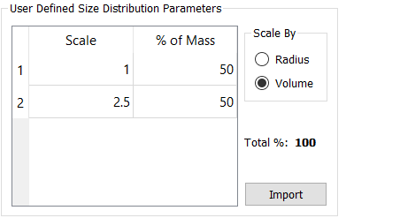

  5. User Defined. Particle radii have a range of sizes applied. Here the user can specify a number of different sizes and what percentage each of the chosen sizes will be used. Additional sizes (“Scale”) can be added or removed by right-clicking in the table. The % of Mass column shows what percentage of the total distribution will be defined for that particularly particle. To the right side of the table the Total % provides the total amount of the mass distribution that has been allocated. This value must equal 100%.

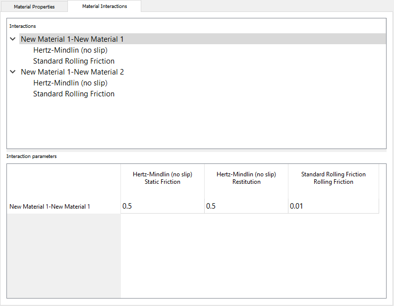

The Material Interactions tab enables the user to define how a material will behave in a simulation when it comes into contact with both itself and other materials. Adding interactions between materials involves the selection of which contact models are to be used, and the specification of the required parameter values for the selected model.
The Material Interactions tab consists of two parts: at the top is an Interactions list for the selected materials and at the bottom a table for the Interaction Parameters, which displays the parameter values that are currently assigned to the interaction properties.
Interactions
You may not want to add interactions with every material in your database, however the interactions between materials must be defined for them to be used together in a simulation. If materials will never be used together in the same simulation, then the user does not need to define these interactions.
When a material, or materials, are selected the Interactions list will show the combinations of materials names that have interactions defined for the selected material. The list of interaction combinations can be expanded to show the contact models that are used for each specific interaction.
When the user selects a combination of material names, or an individual interaction, from this list, the relevant details will be shown in the Interaction Parameters table along with the values for each parameters. The content of the list will also depend on what materials are selected in the Materials pane. All of the defined interactions, for each selected material, will be shown.

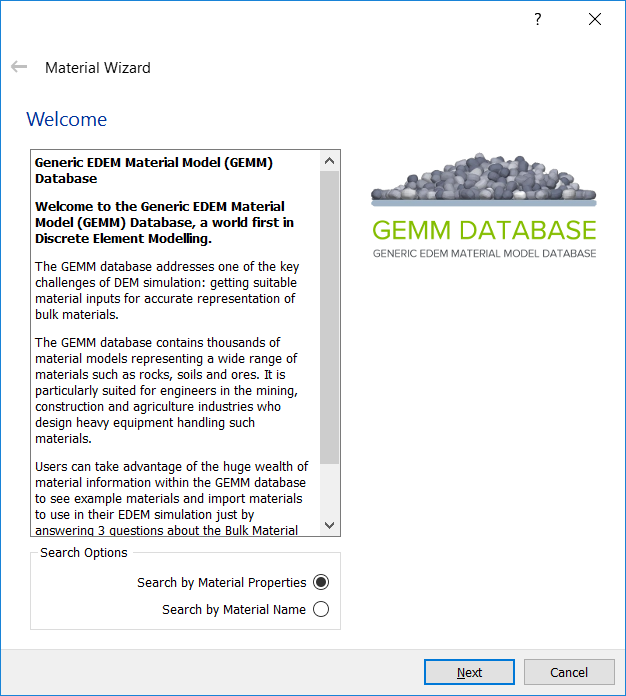

The GEMM database addresses one of the key challenges of DEM simulation: getting suitable material inputs for accurate representation of bulk materials.
The GEMM database contains thousands of material models representing a wide range of materials such as rocks, soils and ores. It is particularly suited for engineers in the mining, construction and agriculture industries who design heavy equipment handling such materials.
Users can take advantage of the huge wealth of material information within the GEMM database to see example materials and download input decks to use in their EDEM simulation just by answering 3 questions about the Bulk Material and one question about the Equipment Material.
To use the GEMM Database click on the Open GEMM Wizard button in the Material Modeler Toolbar.
The first page is a description of the database, read, select “Search by Material Properties” and choose Next to answer the 3 questions on the particle Bulk Material behavior.

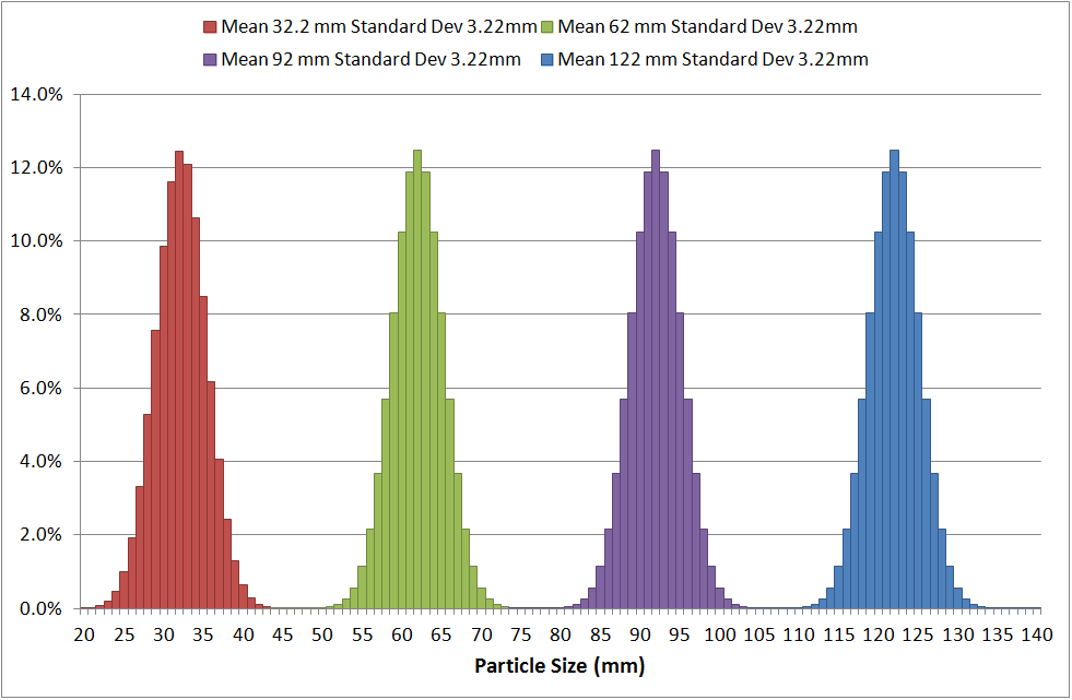

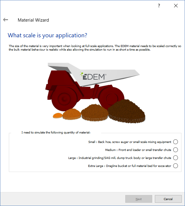

  1. What scale is your application?
    The GEMM Database contains several different sets of materials which are designed to cover a range of different material sizes. Each one has a size distribution based around a median value.
If you are not sure which size distribution to choose, start with the largest and test it on the application. It is faster to work with a test case where the particles are too large than it is to work with a case where they are too small because - with a large scale material - the particle count will be lower and therefore the simulation will progress quickly. If the particles are too small it can take a long time to fill a volume instead of progressing with the simulation.
The actual size ranges used in the GEMM database are shown as follows:

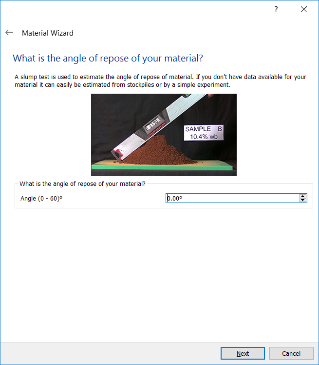

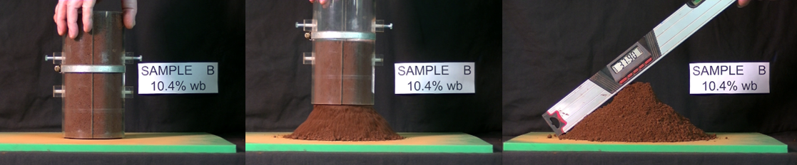

  1. What is the angle of repose of your particle material?
The angle of repose is a commonly available measure of material that is contained in standard test data. Even if such data is not available in existing material data reports, it is a quantity that can be measured in a relatively easy way without specialist equipment (for example, observing the angle of a stockpile). Finally, if there is no access to any testing reports or on-site data, then it is a quantity that is relatively easy to estimate based on engineering experience.
It is difficult to measure an angle of repose to a high accuracy so it is usually treated as an approximation to the material behavior rather than defining it completely. For this reason the material model provided by the GEMM Database should be used as a guide or starting point, and the user must be aware that differences in behavior might still occur.
An example angle of repose test is shown as follows:
The maximum value for Angle of Repose in the GEMM database is 60 degrees, any materials with angles higher than this should be calibrated separately, the lowest angles can be found between 20 and 30 degrees.

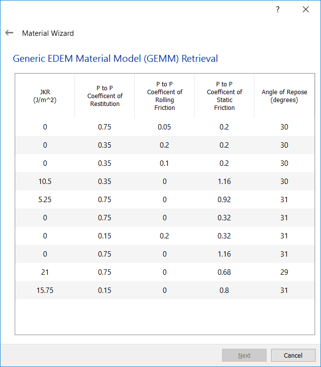

Once these 3 questions are answered a list of 10 materials is provided. These materials are the 10 closest matches based on the answers that have been given.
You can choose from one of these materials, the top material is the closest match to the input angle of repose; however, other materials can also be chosen from the list.
P to P refers to the Particle to Particle values of Restitution, Static Friction and Rolling Friction. The JKR value is the cohesive energy value for this material. A ‘sticky’ material will tend to have a higher JKR value than a non-sticky material even if both materials have the same angle of repose. High JKR cohesion values are best paired with higher coefficients of restitution to avoid overly damped simulations.
