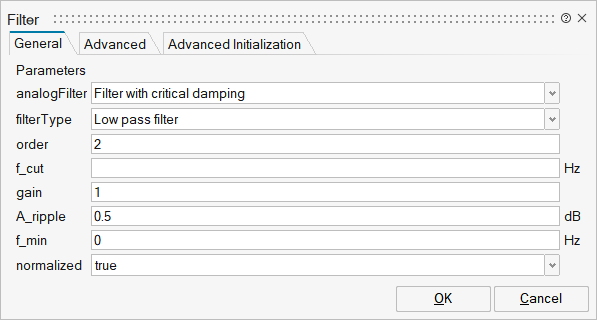

Continuous low pass, high pass, band pass or band stop IIR-filter of type CriticalDamping, Bessel, Butterworth or ChebyshevI
Blocks/Continuous
This blocks models various types of filters:
low pass, high pass, band pass, and band stop filters
using various filter characteristics:
CriticalDamping, Bessel, Butterworth, Chebyshev Type I filters

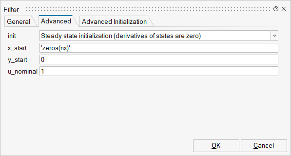

By default, a filter block is initialized in steady-state, in order to avoid unwanted oscillations at the beginning. In special cases, it might be useful to select one of the other initialization options under tab "Advanced".

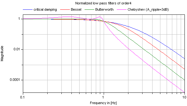

Typical frequency responses for the 4 supported low pass filter types are shown in the next figure:

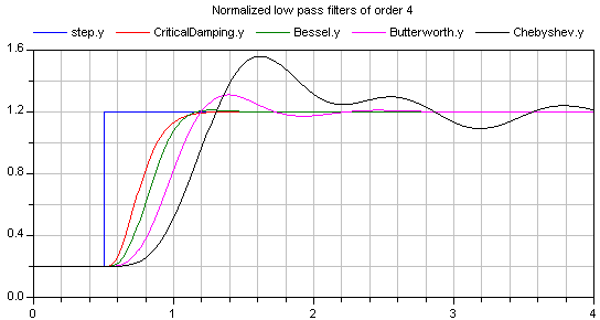

The step responses of the same low pass filters are shown in the next figure, starting from a steady state initial filter with initial input = 0.2:
Obviously, the frequency responses give a somewhat wrong impression of the filter characteristics: Although Butterworth and Chebyshev filters have a significantly steeper magnitude as the CriticalDamping and Bessel filters, the step responses of the latter ones are much better. This means for example, that a CriticalDamping or a Bessel filter should be selected, if a filter is mainly used to make a non-linear inverse model realizable.

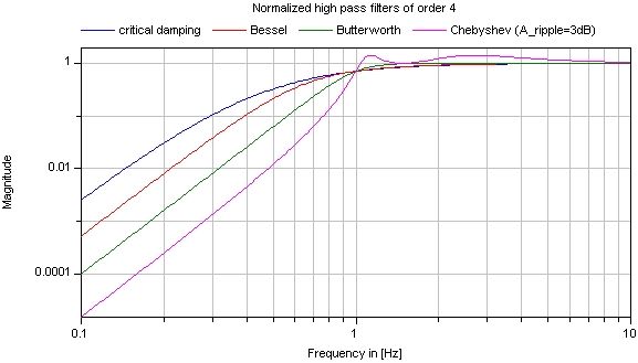

Typical frequency responses for the 4 supported high pass filter types are shown in the next figure:

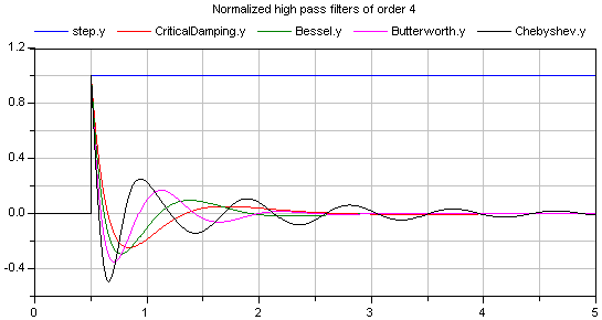

The corresponding step responses of these high pass filters are shown in the next figure:
All filters are available in normalized (default) and non-normalized form. In the normalized form, the amplitude of the filter transfer function at the cut-off frequency f_cut is -3 dB (= 10^(-3/20) = 0.70794..). Note, when comparing the filters of this function with other software systems, the setting of "normalized" has to be selected appropriately. For example, the signal processing toolbox of MATLAB provides the filters in non-normalized form and therefore a comparison makes only sense, if normalized = false is set. A normalized filter is usually better suited for applications, since filters of different orders are "comparable", whereas non-normalized filters usually require to adapt the cut-off frequency, when the order of the filter is changed. See a comparison of "normalized" and "non-normalized" filters at hand of CriticalDamping filters of order 1,2,3:

mo_analogFilter | analogFilter | Analog filter characteristics (CriticalDamping/Bessel/Butterworth/ChebyshevI) | Structure | |
mo_analogFilter/choice1 | Filter with critical damping | Number | 0 | |
mo_analogFilter/choice2 | Bessel filter | Number | 0 | |
mo_analogFilter/choice3 | Butterworth filter | Number | 0 | |
mo_analogFilter/choice4 | Chebyshev I filter | Number | 0 | |
mo_filterType | filterType | Type of filter (LowPass/HighPass/BandPass/BandStop) | Structure | |
mo_filterType/choice1 | Low pass filter | Number | 0 | |
mo_filterType/choice2 | High pass filter | Number | 0 | |
mo_filterType/choice3 | Band pass filter | Number | 0 | |
mo_filterType/choice4 | Band stop / notch filter | Number | 0 | |
mo_order | order | Order of filter | Scalar | |
mo_f_cut | f_cut | Cut-off frequency | Scalar | |
mo_gain | gain | Gain (= amplitude of frequency response at zero frequency) | Scalar | |
mo_A_ripple | A_ripple | Pass band ripple for Chebyshev filter (otherwise not used); > 0 required | Scalar | |
mo_f_min | f_min | Band of band pass/stop filter is f_min (A=-3db*gain) .. f_cut (A=-3db*gain) | Scalar | |
mo_normalized | normalized | = true, if amplitude at f_cut = -3db, otherwise unmodified filter | Scalar | true |

mo_init | init | Type of initialization (no init/steady state/initial state/initial output) | Structure | |
mo_init/choice1 | No initialization (start values are used as guess values with fixed=false) | Number | 0 | |
mo_init/choice2 | Steady state initialization (derivatives of states are zero) | Number | 0 | |
mo_init/choice3 | Initialization with initial states | Number | 0 | |
mo_init/choice4 | Initialization with initial outputs (and steady state of the states if possible) | Number | 0 | |
mo_x_start | x_start | Initial or guess values of states | Vector | |
mo_y_start | y_start | Initial value of output | Scalar | |
mo_u_nominal | u_nominal | Nominal value of input (used for scaling the states) | Scalar |

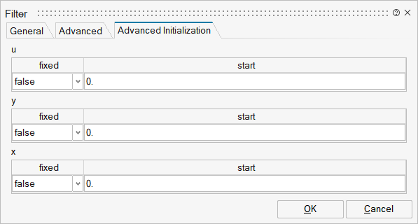

mo_u | u | u | Structure | |
mo_u/fixed | fixed | Cell of scalars | true | |
mo_u/start | start | Cell of scalars | ||
mo_y | y | y | Structure | |
mo_y/fixed | fixed | Cell of scalars | true | |
mo_y/start | start | Cell of scalars | ||
mo_x | x | x | Structure | |
mo_x/fixed | fixed | Cell of vectors | true | |
mo_x/start | start | Cell of vectors |
