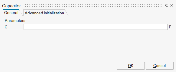

The linear capacitor connects the branch voltage v with the branch current i by i = C * dv/dt. The Capacitance C is allowed to be positive or zero.
mo_C | C | Capacitance | Scalar |

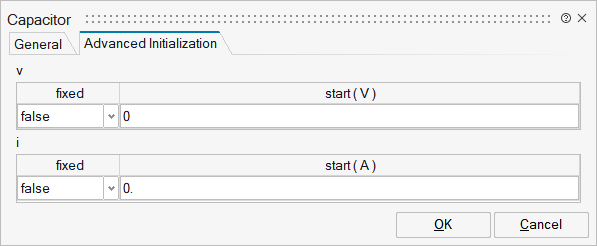

mo_v | v | v | Structure | |
mo_v/fixed | fixed | Cell of scalars | true | |
mo_v/start | start | Cell of scalars | ||
mo_i | i | i | Structure | |
mo_i/fixed | fixed | Cell of scalars | true | |
mo_i/start | start | Cell of scalars |
