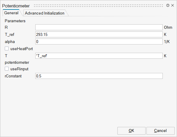

This models a potentiometer where the sliding contact is placed between pin_n (r = 0) and pin_p (r = 1), dependent on either the parameter rConstant or the signal input r.
The total resistance R is temperature dependent.
mo_R | R | Resistance at temperature T_ref | Scalar | |
mo_T_ref | T_ref | Reference temperature | Scalar | |
mo_alpha | alpha | Temperature coefficient of resistance (R_actual = R*(1 + alpha*(T_heatPort - T_ref)) | Scalar | |
mo_T | T | Fixed device temperature if useHeatPort = false | Scalar | |
mo_useRinput | useRinput | use input for 0<r<1 (else constant) | Number | 0 |
mo_rConstant | rConstant | Contact between n (r=0) and p (r=1) | Scalar |

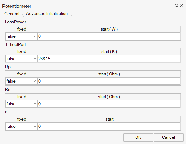

mo_LossPower | LossPower | LossPower | Structure | |
mo_LossPower/fixed | fixed | Cell of scalars | true | |
mo_LossPower/start | start | Cell of scalars | ||
mo_T_heatPort | T_heatPort | T_heatPort | Structure | |
mo_T_heatPort/fixed | fixed | Cell of scalars | true | |
mo_T_heatPort/start | start | Cell of scalars | ||
mo_Rp | Rp | Rp | Structure | |
mo_Rp/fixed | fixed | Cell of scalars | true | |
mo_Rp/start | start | Cell of scalars | ||
mo_Rn | Rn | Rn | Structure | |
mo_Rn/fixed | fixed | Cell of scalars | true | |
mo_Rn/start | start | Cell of scalars | ||
mo_r | r | r | Structure | |
mo_r/fixed | fixed | Cell of scalars | true | |
mo_r/start | start | Cell of scalars |
