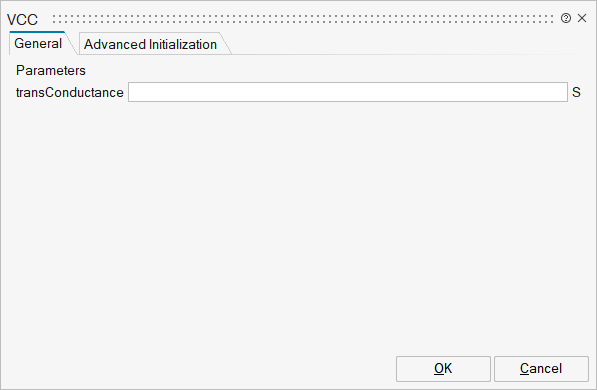

The linear voltage-controlled current source is a TwoPort. The right port current i2 is controlled by the left port voltage v1 via
i2 = v1 * transConductance.
The left port current is zero. Any transConductance can be chosen.

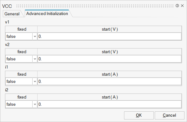

mo_transConductance | transConductance | Transconductance | Scalar |
mo_v1 | v1 | v1 | Structure | |
mo_v1/fixed | fixed | Cell of scalars | true | |
mo_v1/start | start | Cell of scalars | ||
mo_v2 | v2 | v2 | Structure | |
mo_v2/fixed | fixed | Cell of scalars | true | |
mo_v2/start | start | Cell of scalars | ||
mo_i1 | i1 | i1 | Structure | |
mo_i1/fixed | fixed | Cell of scalars | true | |
mo_i1/start | start | Cell of scalars | ||
mo_i2 | i2 | i2 | Structure | |
mo_i2/fixed | fixed | Cell of scalars | true | |
mo_i2/start | start | Cell of scalars |
