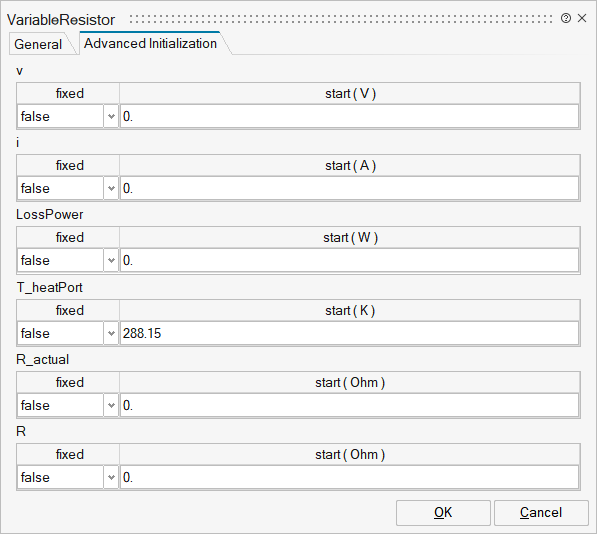

mo_v | v | v | Structure | |
mo_v/fixed | fixed | Cell of scalars | true | |
mo_v/start | start | Cell of scalars | ||
mo_i | i | i | Structure | |
mo_i/fixed | fixed | Cell of scalars | true | |
mo_i/start | start | Cell of scalars | ||
mo_LossPower | LossPower | LossPower | Structure | |
mo_LossPower/fixed | fixed | Cell of scalars | true | |
mo_LossPower/start | start | Cell of scalars | ||
mo_T_heatPort | T_heatPort | T_heatPort | Structure | |
mo_T_heatPort/fixed | fixed | Cell of scalars | true | |
mo_T_heatPort/start | start | Cell of scalars | ||
mo_R_actual | R_actual | R_actual | Structure | |
mo_R_actual/fixed | fixed | Cell of scalars | true | |
mo_R_actual/start | start | Cell of scalars | ||
mo_R | R | R | Structure | |
mo_R/fixed | fixed | Cell of scalars | true | |
mo_R/start | start | Cell of scalars |
