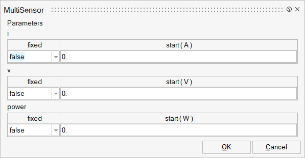

mo_i | i | i | Structure | |
mo_i/fixed | fixed | Cell of scalars | true | |
mo_i/start | start | Cell of scalars | ||
mo_v | v | v | Structure | |
mo_v/fixed | fixed | Cell of scalars | true | |
mo_v/start | start | Cell of scalars | ||
mo_power | power | power | Structure | |
mo_power/fixed | fixed | Cell of scalars | true | |
mo_power/start | start | Cell of scalars |
