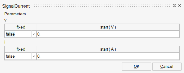

The signal current source is a parameterless converter of real valued signals into a the source current. No further effects are modeled. The real valued signal has to be provided by components of the blocks library. It can be regarded as the "Opposite" of a current sensor.
mo_v | v | v | Structure | |
mo_v/fixed | fixed | Cell of scalars | true | |
mo_v/start | start | Cell of scalars | ||
mo_i | i | i | Structure | |
mo_i/fixed | fixed | Cell of scalars | true | |
mo_i/start | start | Cell of scalars |
p | implicit | input | 1 | |
n | implicit | output | 1 | |
i | implicit | Current flowing from pin p to pin n as input signal | input | 2 |
