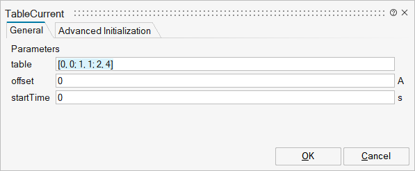

This block generates a current source by linear interpolation in a table. The time points and current values are stored in a matrix table[i,j], where the first column table[:,1] contains the time points and the second column contains the current to be interpolated. The table interpolation has the following properties:
- The time points need to be monotonically increasing.
- Discontinuities are allowed, by providing the same time point twice in the table.
- Values outside of the table range, are computed by extrapolation through the last or first two points of the table.
- If the table has only one row, no interpolation is performed and the current value is just returned independently of the actual time instant, i.e., this is a constant current source.
- Via parameters startTime and offset the curve defined by the table can be shifted both in time and in the current.
- The table is implemented in a numerically sound way by generating time events at interval boundaries. This generates continuously differentiable values for the integrator.

mo_table | table | Table matrix (time = first column, current = second column) | Matrix | |
mo_offset | offset | Current offset | Scalar | |
mo_startTime | startTime | Time offset | Scalar |

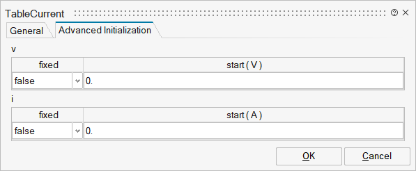

mo_v/start | start | Cell of scalars | ||
mo_i | i | i | Structure | |
mo_i/fixed | fixed | Cell of scalars | true | |
mo_i/start | start | Cell of scalars |
