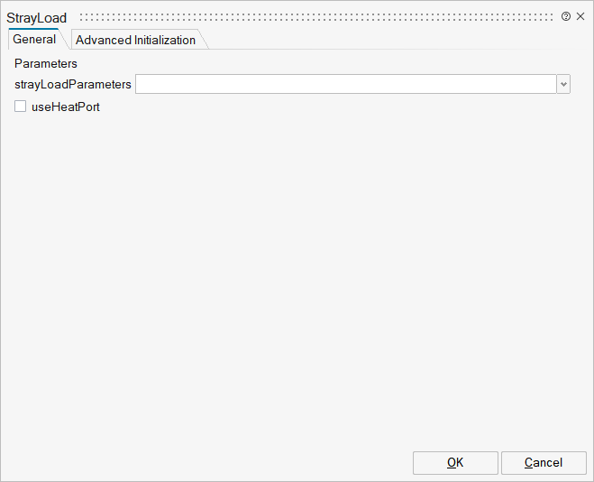

If it is desired to neglect stray load losses, set strayLoadParameters.PRef = 0 (this is the default).
mo_strayLoadParameters | strayLoadParameters | Stray load loss parameters | FromModelica('Modelica.Electrical.Machines.Losses.StrayLoadParameters') | |

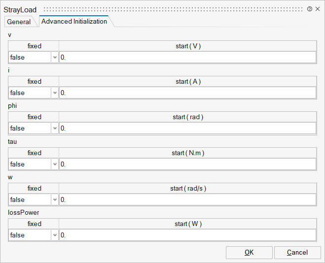

mo_v/start | start | Cell of scalars | ||
mo_i | i | i | Structure | |
mo_i/fixed | fixed | Cell of scalars | true | |
mo_i/start | start | Cell of scalars | ||
mo_phi | phi | phi | Structure | |
mo_phi/fixed | fixed | Cell of scalars | true | |
mo_phi/start | start | Cell of scalars | ||
mo_tau | tau | tau | Structure | |
mo_tau/fixed | fixed | Cell of scalars | true | |
mo_tau/start | start | Cell of scalars | ||
mo_w | w | w | Structure | |
mo_w/fixed | fixed | Cell of scalars | true | |
mo_w/start | start | Cell of scalars | ||
mo_lossPower | lossPower | lossPower | Structure | |
mo_lossPower/fixed | fixed | Cell of scalars | true | |
mo_lossPower/start | start | Cell of scalars |

Port 5 | implicit | Optional port to which dissipated losses are transported in form of heat | input | mo_useHeatPort |
