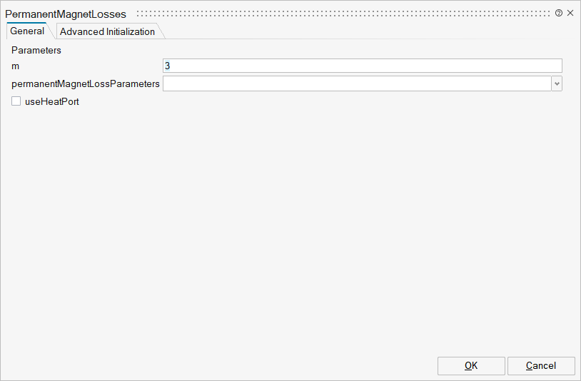

Permanent magnet loss parameters
If it is desired to neglect permanent magnet losses, set strayLoadParameters.PRef = 0 (this is the default).

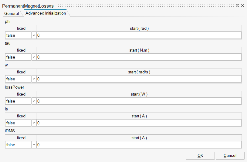

mo_tau | tau | tau | Structure | |
mo_tau/fixed | fixed | Cell of scalars | true | |
mo_tau/start | start | Cell of scalars | ||
mo_w | w | w | Structure | |
mo_w/fixed | fixed | Cell of scalars | true | |
mo_w/start | start | Cell of scalars | ||
mo_lossPower | lossPower | lossPower | Structure | |
mo_lossPower/fixed | fixed | Cell of scalars | true | |
mo_lossPower/start | start | Cell of scalars | ||
mo_is | is | is | Structure | |
mo_is/fixed | fixed | Cell of vectors | true | |
mo_is/start | start | Cell of vectors | ||
mo_iRMS | iRMS | iRMS | Structure | |
mo_iRMS/fixed | fixed | Cell of scalars | true | |
mo_iRMS/start | start | Cell of scalars |
