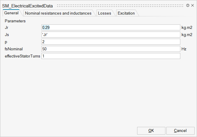

mo_Jr | Jr | Rotor's moment of inertia | Scalar | |
mo_Js | Js | Stator's moment of inertia | Scalar | |
mo_p | p | Number of pole pairs (Integer) | Scalar | |
mo_fsNominal | fsNominal | Nominal frequency | Scalar | |
mo_effectiveStatorTurns | effectiveStatorTurns | Effective number of stator turns | Scalar |

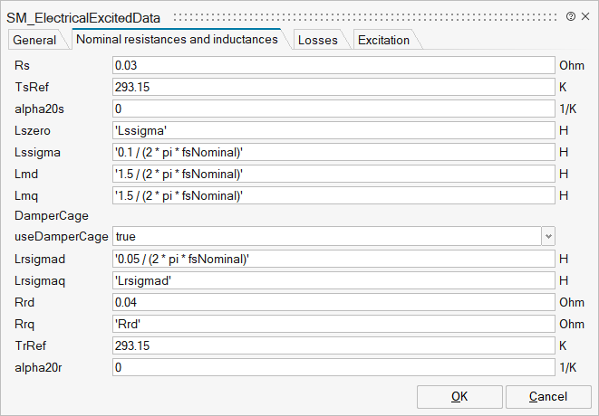

mo_Rs | Rs | Stator resistance per phase at TRef | Scalar | |
mo_TsRef | TsRef | Reference temperature of stator resistance | Scalar | |
mo_alpha20s | alpha20s | Temperature coefficient of stator resistance at 20 degC | Scalar | |
mo_Lszero | Lszero | Stator zero sequence inductance | Scalar | |
mo_Lssigma | Lssigma | Stator stray inductance per phase | Scalar | |
mo_Lmd | Lmd | Stator main field inductance per phase in d-axis | Scalar | |
mo_Lmq | Lmq | Stator main field inductance per phase in q-axis | Scalar | |
mo_useDamperCage | useDamperCage | Enable / disable damper cage | Scalar | true |
mo_Lrsigmad | Lrsigmad | Damper stray inductance in d-axis | Scalar | |
mo_Lrsigmaq | Lrsigmaq | Damper stray inductance in q-axis | Scalar | |
mo_Rrd | Rrd | Damper resistance in d-axis at TRef | Scalar | |
mo_Rrq | Rrq | Damper resistance in q-axis at TRef | Scalar | |
mo_TrRef | TrRef | Reference temperature of damper resistances in d- and q-axis | Scalar | |
mo_alpha20r | alpha20r | Temperature coefficient of damper resistances in d- and q-axis | Scalar |

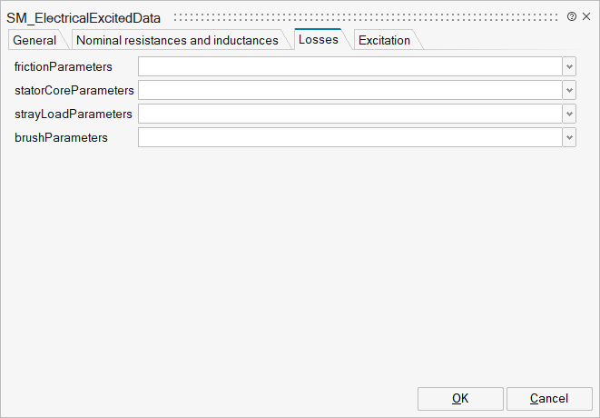

mo_frictionParameters | frictionParameters | Friction loss parameter record | FromModelica('Modelica.Electrical.Machines.Losses.FrictionParameters') | |
mo_statorCoreParameters | statorCoreParameters | Stator core loss parameter record; all parameters refer to stator side | FromModelica('Modelica.Electrical.Machines.Losses.CoreParameters') | |
mo_strayLoadParameters | strayLoadParameters | Stray load losses | FromModelica('Modelica.Electrical.Machines.Losses.StrayLoadParameters') | |
mo_brushParameters | brushParameters | Brush loss parameter record | FromModelica('Modelica.Electrical.Machines.Losses.BrushParameters') |

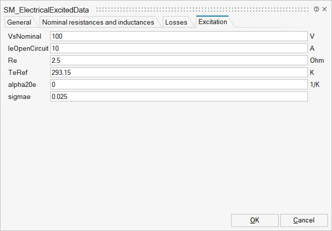

mo_VsNominal | VsNominal | Nominal stator RMS voltage per phase | Scalar | |
mo_IeOpenCircuit | IeOpenCircuit | Open circuit excitation current @ nominal voltage and frequency | Scalar | |
mo_Re | Re | Excitation resistance at TRef | Scalar | |
mo_TeRef | TeRef | Reference temperature of excitation resistance | Scalar | |
mo_alpha20e | alpha20e | Temperature coefficient of excitation resistance | Scalar | |
mo_sigmae | sigmae | Stray fraction of total excitation inductance | Scalar |
