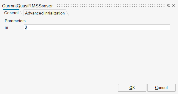

mo_m | m | Number of phases | Scalar |

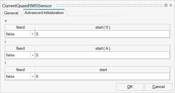

mo_v/start | start | Cell of vectors | ||
mo_i | i | i | Structure | |
mo_i/fixed | fixed | Cell of vectors | true | |
mo_i/start | start | Cell of vectors | ||
mo_I | I | I | Structure | |
mo_I/fixed | fixed | Cell of scalars | true | |
mo_I/start | start | Cell of scalars |
