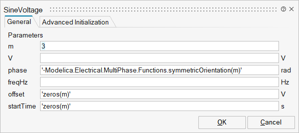

SineVoltage
Multiphase sine voltage source
Electrical/MultiPhase/Sources
Contains m sine voltage sources (Modelica.Electrical.Analog.Sources.SineVoltage) with a default phase shift determined by symmetricOrientation.
mo_V | V | Amplitudes of sine waves | Vector | |
mo_phase | phase | Phases of sine waves | Vector | |
mo_freqHz | freqHz | Frequencies of sine waves | Vector | |
mo_offset | offset | Voltage offsets | Vector | |
mo_startTime | startTime | Time offsets | Vector |

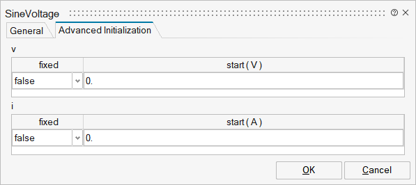

mo_v | v | v | Structure | |
mo_v/fixed | fixed | Cell of vectors | true | |
mo_v/start | start | Cell of vectors | ||
mo_i | i | i | Structure | |
mo_i/fixed | fixed | Cell of vectors | true | |
mo_i/start | start | Cell of vectors |
