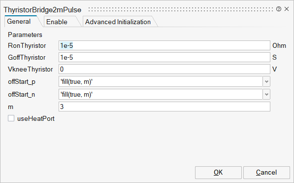

This is a 2*m pulse thyristor rectifier bridge. In order to operate this rectifier a voltage source with center tap is required. It is important to note that for multi phase circuits with phase even phase numbers greater than three the MultiStarResistance shall be used for grounding the voltage sources. See example Examples.ACDC.RectifierBridge2mPulse.
mo_RonThyristor | RonThyristor | Closed thyristor resistance | Scalar | |
mo_GoffThyristor | GoffThyristor | Opened thyristor conductance | Scalar | |
mo_VkneeThyristor | VkneeThyristor | Thyristor forward threshold voltage | Scalar | |
mo_offStart_p | offStart_p | Boolean start value of variable thyristor_p[:].off | Vector | true |
mo_offStart_n | offStart_n | Boolean start value of variable thyristor_n[:].off | Vector | true |
mo_T | T | Fixed device temperature if useHeatPort = false | Scalar |

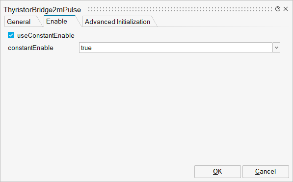

mo_useConstantEnable | useConstantEnable | true = disabled boolean input, use constantEnable | Number | 0 |
mo_constantEnable | constantEnable | Constant enabling of firing signals | Scalar | true |

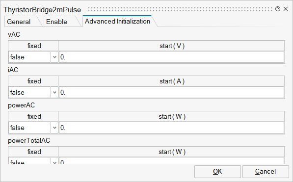

mo_vAC | vAC | vAC | Structure | |
mo_vAC/fixed | fixed | Cell of vectors | true | |
mo_vAC/start | start | Cell of vectors | ||
mo_iAC | iAC | iAC | Structure | |
mo_iAC/fixed | fixed | Cell of vectors | true | |
mo_iAC/start | start | Cell of vectors | ||
mo_powerAC | powerAC | powerAC | Structure | |
mo_powerAC/fixed | fixed | Cell of vectors | true | |
mo_powerAC/start | start | Cell of vectors | ||
mo_powerTotalAC | powerTotalAC | powerTotalAC | Structure | |
mo_powerTotalAC/fixed | fixed | Cell of scalars | true | |
mo_powerTotalAC/start | start | Cell of scalars | ||
