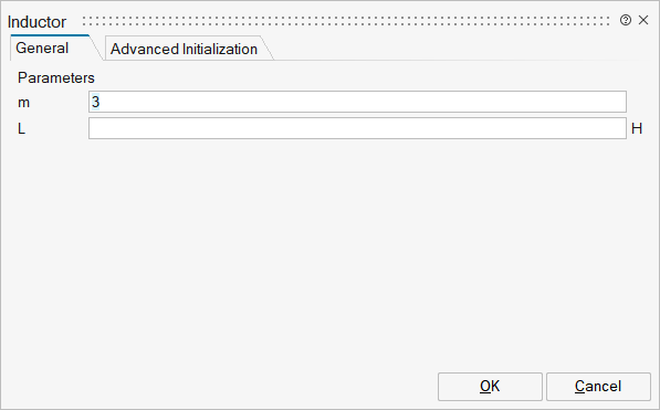

Inductor
Multiphase linear inductor
Electrical/QuasiStationary/MultiPhase/Basic
The linear inductor connects the complex voltages v with the complex
currents i by i*j*ω*L = v,
using m single phase Inductors.
