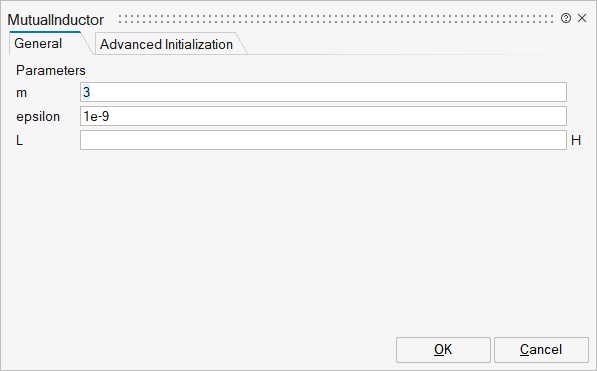

mo_epsilon | epsilon | Relative accuracy tolerance of matrix symmetry | Scalar | |
mo_L | L | Mutual inductance matrix | Matrix |

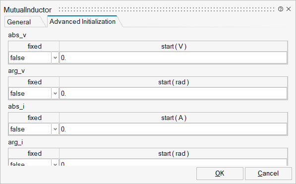

mo_abs_v | abs_v | abs_v | Structure | |
mo_abs_v/fixed | fixed | Cell of vectors | true | |
mo_abs_v/start | start | Cell of vectors | ||
mo_arg_v | arg_v | arg_v | Structure | |
mo_arg_v/fixed | fixed | Cell of vectors | true | |
mo_arg_v/start | start | Cell of vectors | ||
mo_abs_i | abs_i | abs_i | Structure | |
mo_abs_i/fixed | fixed | Cell of vectors | true | |
mo_abs_i/start | start | Cell of vectors | ||
mo_arg_i | arg_i | arg_i | Structure | |
mo_arg_i/fixed | fixed | Cell of vectors | true | |
mo_arg_i/start | start | Cell of vectors | ||
