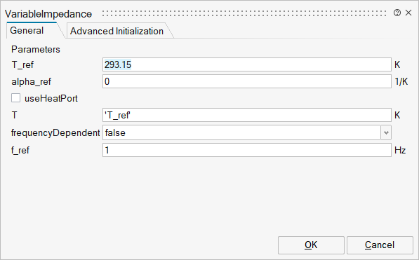

mo_T_ref | T_ref | Reference temperature | Scalar | |
mo_alpha_ref | alpha_ref | Temperature coefficient of resistance (R_actual = R_ref*(1 + alpha_ref*(heatPort.T - T_ref)) | Scalar | |
mo_T | T | Fixed device temperature if useHeatPort = false | Scalar | |
mo_frequencyDependent | frequencyDependent | Consider frequency dependency, if true | Scalar | true |
mo_f_ref | f_ref | Reference frequency, if frequency dependency is considered | Scalar |

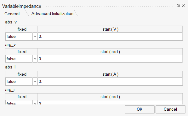

mo_abs_v | abs_v | abs_v | Structure | |
mo_abs_v/fixed | fixed | Cell of scalars | true | |
mo_abs_v/start | start | Cell of scalars | ||
mo_arg_v | arg_v | arg_v | Structure | |
mo_arg_v/fixed | fixed | Cell of scalars | true | |
mo_arg_v/start | start | Cell of scalars | ||
mo_abs_i | abs_i | abs_i | Structure | |
mo_abs_i/fixed | fixed | Cell of scalars | true | |
mo_abs_i/start | start | Cell of scalars | ||
mo_arg_i | arg_i | arg_i | Structure | |
mo_arg_i/fixed | fixed | Cell of scalars | true | |
mo_arg_i/start | start | Cell of scalars | ||
mo_P | P | P | Structure | |
mo_P/fixed | fixed | Cell of scalars | true | |
mo_P/start | start | Cell of scalars | ||
mo_Q | Q | Q | Structure | |
mo_Q/fixed | fixed | Cell of scalars | true | |
mo_Q/start | start | Cell of scalars | ||
mo_S | S | S | Structure | |
mo_S/fixed | fixed | Cell of scalars | true | |
mo_S/start | start | Cell of scalars | ||
mo_pf | pf | pf | Structure | |
mo_pf/fixed | fixed | Cell of scalars | true | |
mo_pf/start | start | Cell of scalars | ||
mo_omega | omega | omega | Structure | |
mo_omega/fixed | fixed | Cell of scalars | true | |
mo_omega/start | start | Cell of scalars | ||
mo_LossPower | LossPower | LossPower | Structure | |
mo_LossPower/fixed | fixed | Cell of scalars | true | |
mo_LossPower/start | start | Cell of scalars | ||
mo_T_heatPort | T_heatPort | T_heatPort | Structure | |
mo_T_heatPort/fixed | fixed | Cell of scalars | true | |
mo_T_heatPort/start | start | Cell of scalars | ||
mo_R_actual | R_actual | R_actual | Structure | |
mo_R_actual/fixed | fixed | Cell of scalars | true | |
mo_R_actual/start | start | Cell of scalars | ||
mo_X_actual | X_actual | X_actual | Structure | |
mo_X_actual/fixed | fixed | Cell of scalars | true | |
mo_X_actual/start | start | Cell of scalars | ||
mo_R_ref | R_ref | R_ref | Structure | |
mo_R_ref/fixed | fixed | Cell of scalars | true | |
mo_R_ref/start | start | Cell of scalars | ||
mo_X_ref | X_ref | X_ref | Structure | |
mo_X_ref/fixed | fixed | Cell of scalars | true | |
mo_X_ref/start | start | Cell of scalars |
