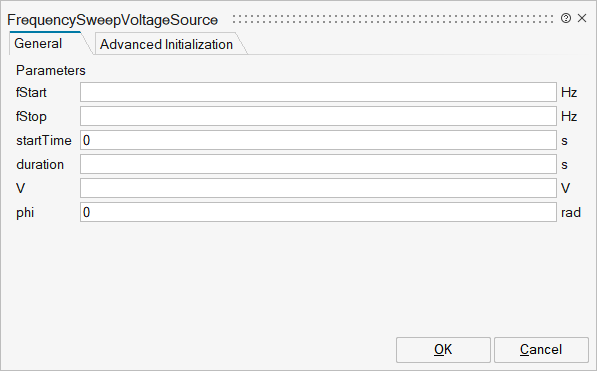

This source provides a constant RMS phase voltage V and phase angle phi,
whereas the frequency sweeps from
fStart to fStop with duration. The frequency sweeps such
way that on a logarithmic frequency scale, the frequency curve appears linear.
mo_fStart | fStart | Start sweep frequency | Scalar | |
mo_fStop | fStop | Stop sweep frequency | Scalar | |
mo_startTime | startTime | Start time of frequency sweep | Scalar | |
mo_duration | duration | Duration of frequency sweep | Scalar | |
mo_V | V | RMS voltage of the source | Scalar | |
mo_phi | phi | phase shift of the source | Scalar |

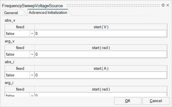

mo_abs_v | abs_v | abs_v | Structure | |
mo_abs_v/fixed | fixed | Cell of scalars | true | |
mo_abs_v/start | start | Cell of scalars | ||
mo_arg_v | arg_v | arg_v | Structure | |
mo_arg_v/fixed | fixed | Cell of scalars | true | |
mo_arg_v/start | start | Cell of scalars | ||
mo_abs_i | abs_i | abs_i | Structure | |
mo_abs_i/fixed | fixed | Cell of scalars | true | |
mo_abs_i/start | start | Cell of scalars | ||
mo_arg_i | arg_i | arg_i | Structure | |
mo_arg_i/fixed | fixed | Cell of scalars | true | |
mo_arg_i/start | start | Cell of scalars | ||
mo_P | P | P | Structure | |
mo_P/fixed | fixed | Cell of scalars | true | |
mo_P/start | start | Cell of scalars | ||
mo_Q | Q | Q | Structure | |
mo_Q/fixed | fixed | Cell of scalars | true | |
mo_Q/start | start | Cell of scalars | ||
mo_S | S | S | Structure | |
mo_S/fixed | fixed | Cell of scalars | true | |
mo_S/start | start | Cell of scalars | ||
mo_pf | pf | pf | Structure | |
mo_pf/fixed | fixed | Cell of scalars | true | |
mo_pf/start | start | Cell of scalars | ||
mo_omega | omega | omega | Structure | |
mo_omega/fixed | fixed | Cell of scalars | true | |
mo_omega/start | start | Cell of scalars | ||
mo_gamma | gamma | gamma | Structure | |
mo_gamma/fixed | fixed | Cell of scalars | true | |
mo_gamma/start | start | Cell of scalars | ||
mo_f | f | f | Structure | |
mo_f/fixed | fixed | Cell of scalars | true | |
mo_f/start | start | Cell of scalars |
