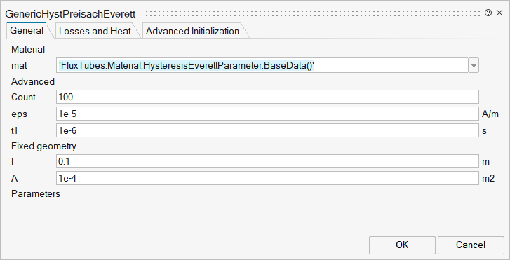

mo_mat | mat | Preisach Parameters | FromModelica('Modelica.Magnetic.FluxTubes.Material.HysteresisEverettParameter.BaseData') | |
mo_Count | Count | Length of history array | Scalar | |
mo_eps | eps | Tolerance in Preisach history | Scalar | |
mo_t1 | t1 | Initialization time | Scalar | |
mo_l | l | Length in direction of flux | Scalar | |
mo_A | A | Area of cross section | Scalar | |
mo_V | V | Volume of FluxTube | Scalar | |

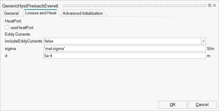

mo_useHeatPort | useHeatPort | =true, if HeatPort is enabled | Number | 0 |
mo_T | T | Fixed device temperature if useHeatPort = false | Scalar | |
mo_includeEddyCurrents | includeEddyCurrents | =true, if eddy current losses are enabled | Scalar | true |
mo_sigma | sigma | Conductivity of core material | Scalar | |
mo_d | d | Thickness of lamination | Scalar |

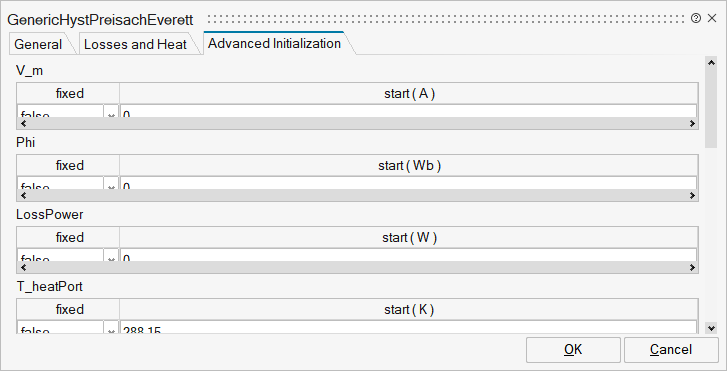

mo_V_m | V_m | V_m | Structure | |
mo_V_m/fixed | fixed | Cell of scalars | true | |
mo_V_m/start | start | Cell of scalars | ||
mo_Phi | Phi | Phi | Structure | |
mo_Phi/fixed | fixed | Cell of scalars | true | |
mo_Phi/start | start | Cell of scalars | ||
mo_LossPower | LossPower | LossPower | Structure | |
mo_LossPower/fixed | fixed | Cell of scalars | true | |
mo_LossPower/start | start | Cell of scalars | ||
mo_T_heatPort | T_heatPort | T_heatPort | Structure | |
mo_T_heatPort/fixed | fixed | Cell of scalars | true | |
mo_T_heatPort/start | start | Cell of scalars | ||
mo_H | H | H | Structure | |
mo_H/fixed | fixed | Cell of scalars | true | |
mo_H/start | start | Cell of scalars | ||
mo_Hstat | Hstat | Hstat | Structure | |
mo_Hstat/fixed | fixed | Cell of scalars | true | |
mo_Hstat/start | start | Cell of scalars | ||
mo_Heddy | Heddy | Heddy | Structure | |
mo_Heddy/fixed | fixed | Cell of scalars | true | |
mo_Heddy/start | start | Cell of scalars | ||
mo_B | B | B | Structure | |
mo_B/fixed | fixed | Cell of scalars | true | |
mo_B/start | start | Cell of scalars | ||
mo_MagRel | MagRel | MagRel | Structure | |
mo_MagRel/fixed | fixed | Cell of scalars | true | |
mo_MagRel/start | start | Cell of scalars | ||
mo_LossPowerStat | LossPowerStat | LossPowerStat | Structure | |
mo_LossPowerStat/fixed | fixed | Cell of scalars | true | |
mo_LossPowerStat/start | start | Cell of scalars | ||
mo_LossPowerEddy | LossPowerEddy | LossPowerEddy | Structure | |
mo_LossPowerEddy/fixed | fixed | Cell of scalars | true | |
mo_LossPowerEddy/start | start | Cell of scalars | ||
mo_derHstat | derHstat | derHstat | Structure | |
mo_derHstat/fixed | fixed | Cell of scalars | true | |
mo_derHstat/start | start | Cell of scalars |
