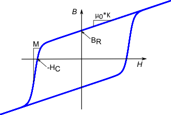

Flux tube element for modeling the ferromagnetic (static) hysteresis of hard magnetic materials. The ferromagnetic hysteresis behavior is defined by the Tellinen hysteresis model. The shape of the limiting hysteresis loop is described by simple hyperbolic tangent functions with 4 parameters.

mo_Br | Br | Remanence | Scalar | |
mo_Hc | Hc | Coercitivity | Scalar | |
mo_M | M | Slope of tanh()-function | Scalar | |
mo_K | K | mu_0 multiplier | Scalar | |

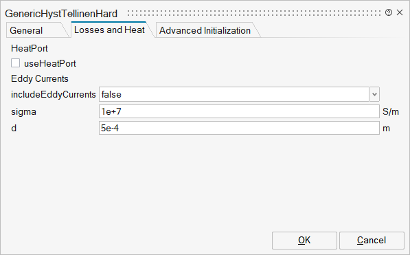

mo_useHeatPort | useHeatPort | =true, if HeatPort is enabled | Number | 0 |
mo_T | T | Fixed device temperature if useHeatPort = false | Scalar | |
mo_includeEddyCurrents | includeEddyCurrents | =true, if eddy current losses are enabled | Scalar | true |
mo_sigma | sigma | Conductivity of core material | Scalar | |
mo_d | d | Thickness of lamination | Scalar |

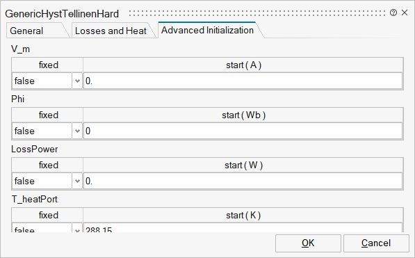

mo_V_m | V_m | V_m | Structure | |
mo_V_m/fixed | fixed | Cell of scalars | true | |
mo_V_m/start | start | Cell of scalars | ||
mo_Phi | Phi | Phi | Structure | |
mo_Phi/fixed | fixed | Cell of scalars | true | |
mo_Phi/start | start | Cell of scalars | ||
mo_LossPower | LossPower | LossPower | Structure | |
mo_LossPower/fixed | fixed | Cell of scalars | true | |
mo_LossPower/start | start | Cell of scalars | ||
mo_T_heatPort | T_heatPort | T_heatPort | Structure | |
mo_T_heatPort/fixed | fixed | Cell of scalars | true | |
mo_T_heatPort/start | start | Cell of scalars | ||
