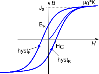

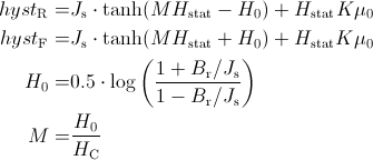

Flux tube element for modeling soft magnetic materials with ferromagnetic and dynamic hysteresis (eddy currents). The ferromagnetic hysteresis behavior is defined by the Tellinen hysteresis model. The shape of the limiting hysteresis loop (see Fig. 1) is described by simple hyperbolic tangent functions with 4 parameters. Therefore, the hysteresis shape variety is limited but the parameterization of the model is very simple and the model is relatively fast and robust. The rising (hystR) and falling (hystF) branches of the limiting hysteresis loop are defined by the following equations.

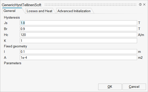

mo_Js | Js | Saturation polarization | Scalar | |
mo_Br | Br | Remanence | Scalar | |
mo_Hc | Hc | Coercitivity | Scalar | |
mo_K | K | mu_0 multiplier | Scalar | |
mo_l | l | Length in direction of flux | Scalar | |
mo_A | A | Area of cross section | Scalar | |
mo_V | V | Volume of FluxTube | Scalar | |
mo_eddyCurrentFactor | eddyCurrentFactor | Scalar | ||
mo_mu0 | mu0 | Scalar | ||
mo_eps | eps | Scalar | ||
mo_H0 | H0 | Scalar | ||
mo_M | M | Scalar | ||
mo_unitH | unitH | Scalar |

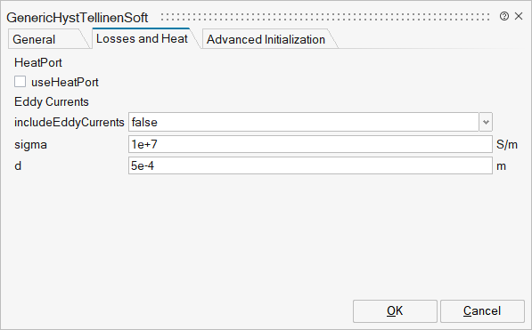

mo_useHeatPort | useHeatPort | =true, if HeatPort is enabled | Number | 0 |
mo_T | T | Fixed device temperature if useHeatPort = false | Scalar | |
mo_includeEddyCurrents | includeEddyCurrents | =true, if eddy current losses are enabled | Scalar | true |
mo_sigma | sigma | Conductivity of core material | Scalar | |
mo_d | d | Thickness of lamination | Scalar |

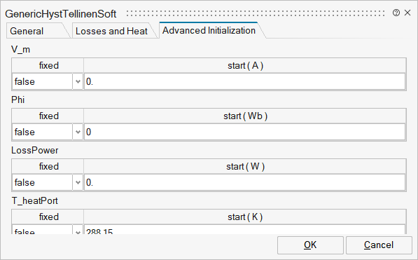

mo_V_m | V_m | V_m | Structure | |
mo_V_m/fixed | fixed | Cell of scalars | true | |
mo_V_m/start | start | Cell of scalars | ||
mo_Phi | Phi | Phi | Structure | |
mo_Phi/fixed | fixed | Cell of scalars | true | |
mo_Phi/start | start | Cell of scalars | ||
mo_LossPower | LossPower | LossPower | Structure | |
mo_LossPower/fixed | fixed | Cell of scalars | true | |
mo_LossPower/start | start | Cell of scalars | ||
mo_T_heatPort | T_heatPort | T_heatPort | Structure | |
mo_T_heatPort/fixed | fixed | Cell of scalars | true | |
mo_T_heatPort/start | start | Cell of scalars | ||
