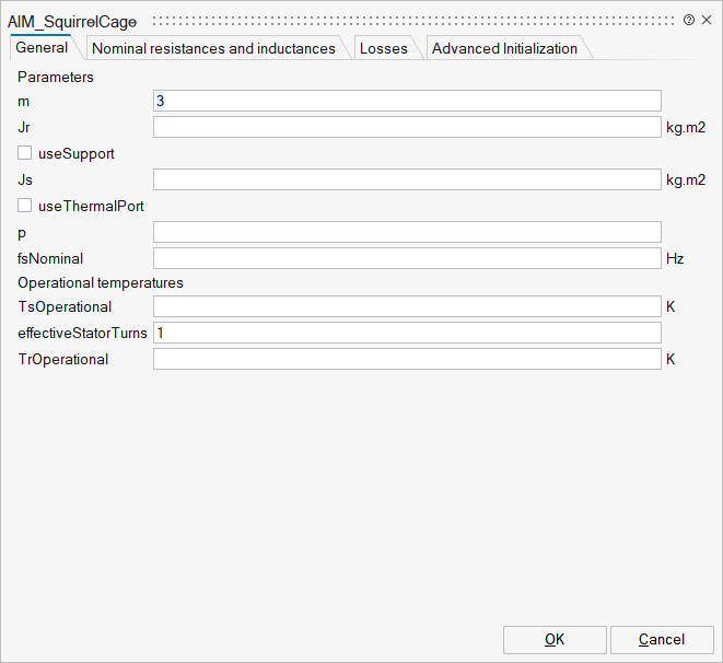

mo_pi | pi | Scalar | ||
mo_m | m | Number of stator phases | Scalar | |
mo_Jr | Jr | Rotor inertia | Scalar | |
mo_useSupport | useSupport | Enable / disable (=fixed stator) support | Number | 0 |
mo_Js | Js | Stator inertia | Scalar | |
mo_useThermalPort | useThermalPort | Enable / disable (=fixed temperatures) thermal port | Number | 0 |
mo_p | p | Number of pole pairs (Integer) | Scalar | |
mo_fsNominal | fsNominal | Nominal frequency | Scalar | |
mo_TsOperational | TsOperational | Operational temperature of stator resistance | Scalar | |
mo_effectiveStatorTurns | effectiveStatorTurns | Effective number of stator turns | Scalar | |
mo_TrOperational | TrOperational | Operational temperature of rotor resistance | Scalar |

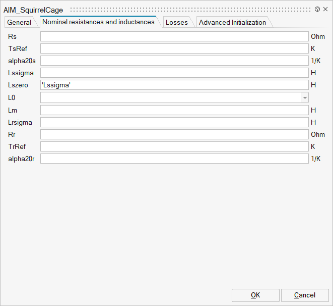

mo_Rs | Rs | Stator resistance per phase at TRef | Scalar | |
mo_TsRef | TsRef | Reference temperature of stator resistance | Scalar | |
mo_alpha20s | alpha20s | Temperature coefficient of stator resistance at 20 degC | Scalar | |
mo_Lssigma | Lssigma | Stator stray inductance | Scalar | |
mo_Lszero | Lszero | Stator zero inductance | Scalar | |
mo_L0 | L0 | Salient inductance of an unchorded coil | FromModelica('Modelica.Magnetic.FundamentalWave.Types.SalientInductance') | |
mo_Lm | Lm | Stator main field inductance | Scalar | |
mo_Lrsigma | Lrsigma | Rotor leakage inductance of equivalent m phase winding w.r.t. stator side | Scalar | |
mo_Rr | Rr | Rotor resistance of equivalent m phase winding w.r.t. stator side | Scalar | |
mo_TrRef | TrRef | Reference temperature of rotor resistance | Scalar | |
mo_alpha20r | alpha20r | Temperature coefficient of rotor resistance at 20 degC | Scalar |

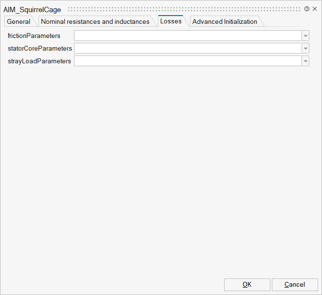

mo_frictionParameters | frictionParameters | Friction loss parameter record | FromModelica('Modelica.Electrical.Machines.Losses.FrictionParameters') | |
mo_statorCoreParameters | statorCoreParameters | Stator core loss parameter record; all parameters refer to stator side | FromModelica('Modelica.Electrical.Machines.Losses.CoreParameters') | |
mo_strayLoadParameters | strayLoadParameters | Stray load loss parameter record | FromModelica('Modelica.Electrical.Machines.Losses.StrayLoadParameters') |

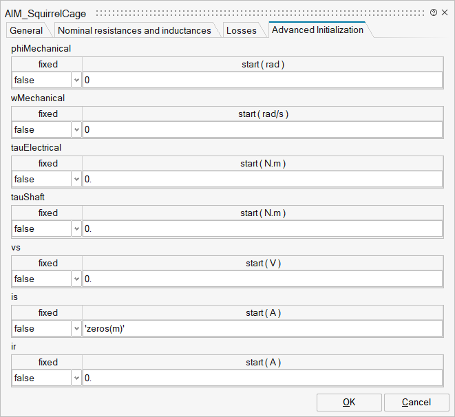

mo_phiMechanical | phiMechanical | phiMechanical | Structure | |
mo_phiMechanical/fixed | fixed | Cell of scalars | true | |
mo_phiMechanical/start | start | Cell of scalars | ||
mo_wMechanical | wMechanical | wMechanical | Structure | |
mo_wMechanical/fixed | fixed | Cell of scalars | true | |
mo_wMechanical/start | start | Cell of scalars | ||
mo_tauElectrical | tauElectrical | tauElectrical | Structure | |
mo_tauElectrical/fixed | fixed | Cell of scalars | true | |
mo_tauElectrical/start | start | Cell of scalars | ||
mo_tauShaft | tauShaft | tauShaft | Structure | |
mo_tauShaft/fixed | fixed | Cell of scalars | true | |
mo_tauShaft/start | start | Cell of scalars | ||
mo_vs | vs | vs | Structure | |
mo_vs/fixed | fixed | Cell of vectors | true | |
mo_vs/start | start | Cell of vectors | ||
mo_is | is | is | Structure | |
mo_is/fixed | fixed | Cell of vectors | true | |
mo_is/start | start | Cell of vectors | ||
mo_ir | ir | ir | Structure | |
mo_ir/fixed | fixed | Cell of vectors | true | |
mo_ir/start | start | Cell of vectors |
