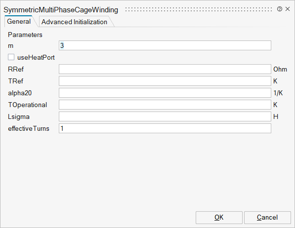

The symmetric rotor cage model of this library does not consist of rotor bars and end rings. Instead the symmetric cage is modeled by an equivalent symmetrical winding. The rotor cage model consists of
phases. If the cage is modeled by equivalent stator winding parameters, the number of effective turns,
, has to be chosen equivalent to the effective number of stator turns.
See also
SinglePhaseWinding, SymmetricMultiPhaseWinding, SaliencyCageWinding, RotorSaliencyAirGap
mo_useHeatPort | useHeatPort | Enable / disable (=fixed temperatures) thermal port | Number | 0 |
mo_RRef | RRef | Winding resistance per phase at TRef | Scalar | |
mo_TRef | TRef | Reference temperature of winding | Scalar | |
mo_alpha20 | alpha20 | Temperature coefficient of winding at 20 degC | Scalar | |
mo_alphaRef | alphaRef | Scalar | ||
mo_TOperational | TOperational | Operational temperature of winding | Scalar | |
mo_Lsigma | Lsigma | Cage stray inductance | Scalar | |
mo_effectiveTurns | effectiveTurns | Effective number of turns | Scalar | |
mo_nBase | nBase | Number of base systems | Scalar |

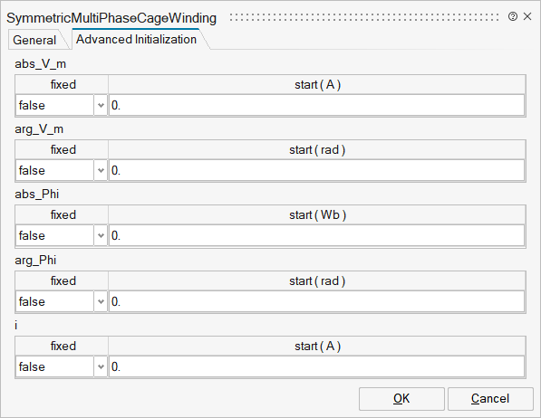

mo_abs_V_m | abs_V_m | abs_V_m | Structure | |
mo_abs_V_m/fixed | fixed | Cell of scalars | true | |
mo_abs_V_m/start | start | Cell of scalars | ||
mo_arg_V_m | arg_V_m | arg_V_m | Structure | |
mo_arg_V_m/fixed | fixed | Cell of scalars | true | |
mo_arg_V_m/start | start | Cell of scalars | ||
mo_abs_Phi | abs_Phi | abs_Phi | Structure | |
mo_abs_Phi/fixed | fixed | Cell of scalars | true | |
mo_abs_Phi/start | start | Cell of scalars | ||
mo_arg_Phi | arg_Phi | arg_Phi | Structure | |
mo_arg_Phi/fixed | fixed | Cell of scalars | true | |
mo_arg_Phi/start | start | Cell of scalars | ||
mo_i | i | i | Structure | |
mo_i/fixed | fixed | Cell of vectors | true | |
mo_i/start | start | Cell of vectors |
