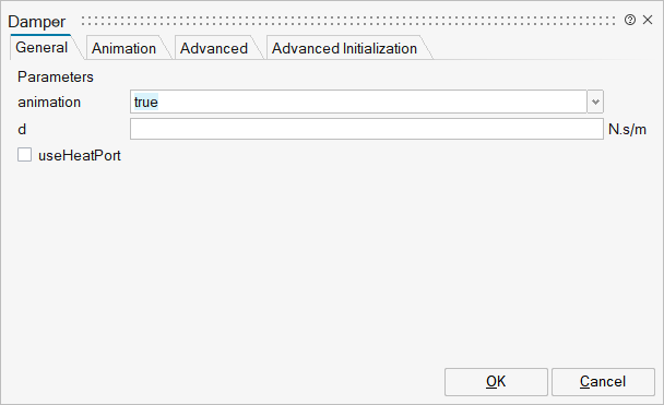

mo_animation | animation | = true, if animation shall be enabled | Scalar | true |
mo_d | d | Damping constant | Scalar | |
mo_T | T | Fixed device temperature if useHeatPort = false | Scalar |

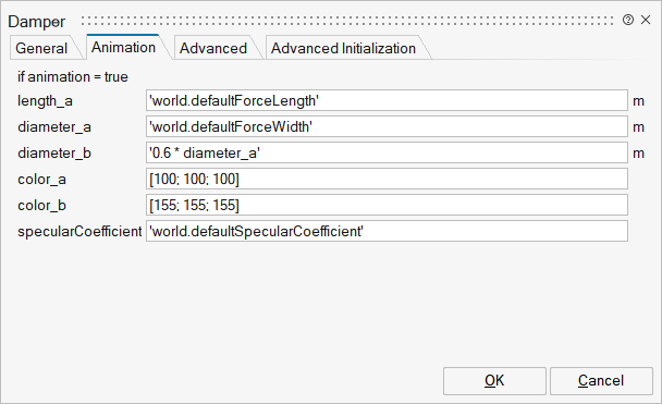

mo_length_a | length_a | Length of cylinder at frame_a side | Scalar | |
mo_diameter_a | diameter_a | Diameter of cylinder at frame_a side | Scalar | |
mo_diameter_b | diameter_b | Diameter of cylinder at frame_b side | Scalar | |
mo_color_a | color_a | Color at frame_a | Vector of size 3 | |
mo_color_b | color_b | Color at frame_b | Vector of size 3 | |
mo_specularCoefficient | specularCoefficient | Reflection of ambient light (= 0: light is completely absorbed) | Scalar |

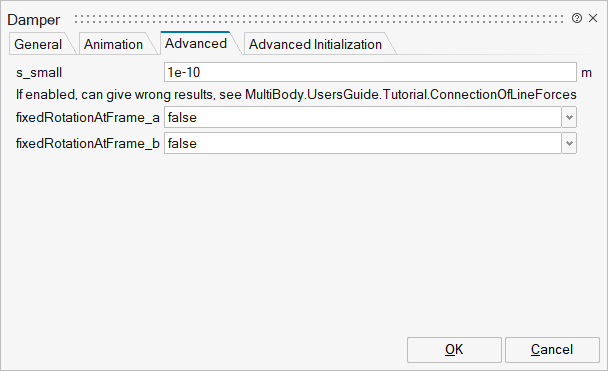

mo_s_small | s_small | Prevent zero-division if distance between frame_a and frame_b is zero | Scalar | |
mo_fixedRotationAtFrame_a | fixedRotationAtFrame_a | =true, if rotation frame_a.R is fixed (to directly connect line forces) | Scalar | true |
mo_fixedRotationAtFrame_b | fixedRotationAtFrame_b | =true, if rotation frame_b.R is fixed (to directly connect line forces) | Scalar | true |

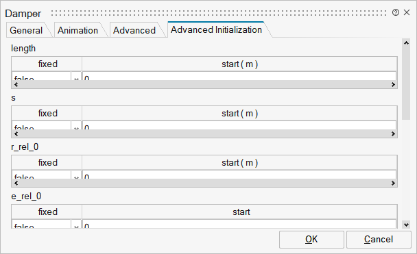

mo_length | length | length | Structure | |
mo_length/fixed | fixed | Cell of scalars | true | |
mo_length/start | start | Cell of scalars | ||
mo_s | s | s | Structure | |
mo_s/fixed | fixed | Cell of scalars | true | |
mo_s/start | start | Cell of scalars | ||
mo_r_rel_0 | r_rel_0 | r_rel_0 | Structure | |
mo_r_rel_0/fixed | fixed | Cell of vectors of size 3 | true | |
mo_r_rel_0/start | start | Cell of vectors of size 3 | ||
mo_e_rel_0 | e_rel_0 | e_rel_0 | Structure | |
mo_e_rel_0/fixed | fixed | Cell of vectors of size 3 | true | |
mo_e_rel_0/start | start | Cell of vectors of size 3 | ||
mo_r_rel_a | r_rel_a | r_rel_a | Structure | |
mo_r_rel_a/fixed | fixed | Cell of vectors of size 3 | true | |
mo_r_rel_a/start | start | Cell of vectors of size 3 | ||
mo_e_a | e_a | e_a | Structure | |
mo_e_a/fixed | fixed | Cell of vectors of size 3 | true | |
mo_e_a/start | start | Cell of vectors of size 3 | ||
mo_f | f | f | Structure | |
mo_f/fixed | fixed | Cell of scalars | true | |
mo_f/start | start | Cell of scalars | ||
mo_lossPower | lossPower | lossPower | Structure | |
mo_lossPower/fixed | fixed | Cell of scalars | true | |
mo_lossPower/start | start | Cell of scalars | ||
mo_TheatPort | TheatPort | TheatPort | Structure | |
mo_TheatPort/fixed | fixed | Cell of scalars | true | |
mo_TheatPort/start | start | Cell of scalars |
