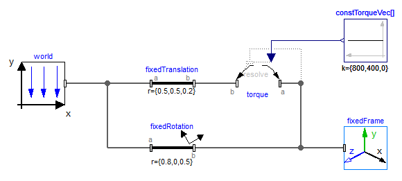

An example how to use this model is given in the following figure:

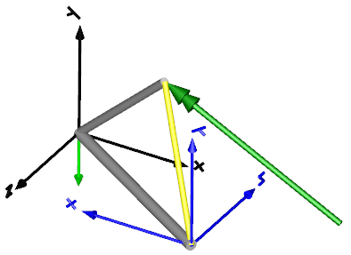

This leads to the following animation (the yellow cylinder characterizes the line between frame_a and frame_b of the Torque component, i.e., the torque acts with negative sign also on the opposite side of this cylinder, but for clarity this is not shown in the animation):

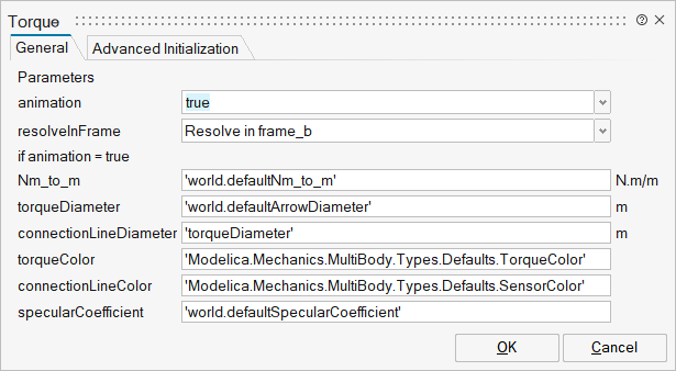

mo_animation | animation | = true, if animation shall be enabled | Scalar | true |
mo_resolveInFrame | resolveInFrame | Frame in which input force is resolved (1: world, 2: frame_a, 3: frame_b, 4: frame_resolve) | Structure | |
mo_resolveInFrame/choice1 | Resolve in world frame | Number | 0 | |
mo_resolveInFrame/choice2 | Resolve in frame_a | Number | 0 | |
mo_resolveInFrame/choice3 | Resolve in frame_b | Number | 0 | |
mo_resolveInFrame/choice4 | Resolve in frame_resolve (frame_resolve must be connected) | Number | 0 | |
mo_Nm_to_m | Nm_to_m | Torque arrow scaling (length = torque/Nm_to_m) | Scalar | |
mo_torqueDiameter | torqueDiameter | Diameter of torque arrow | Scalar | |
mo_connectionLineDiameter | connectionLineDiameter | Diameter of line connecting frame_a and frame_b | Scalar | |
mo_torqueColor | torqueColor | Color of torque arrow | Vector of size 3 | |
mo_connectionLineColor | connectionLineColor | Color of line connecting frame_a and frame_b | Vector of size 3 | |
mo_specularCoefficient | specularCoefficient | Reflection of ambient light (= 0: light is completely absorbed) | Scalar |

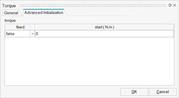

mo_torque | torque | torque | Structure | |
mo_torque/fixed | fixed | Cell of vectors of size 3 | true | |
mo_torque/start | start | Cell of vectors of size 3 |
